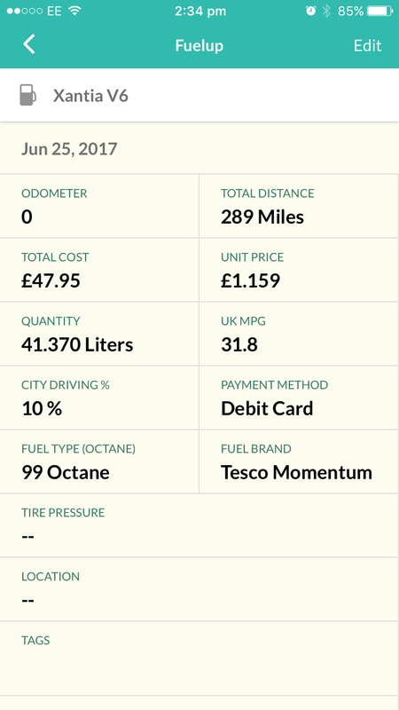

So we're back from our holiday weekend up north and everything went fine on the car front. :-D
240 miles from Motherwell to Embo (near Dornoch) on Friday, then about 200 miles from Embo to John 'O Groats and back on Sunday (just to say we have been to the tip of Scotland :lol: ) and another 240 miles home again on Monday. So 680 miles all up.
The trip up I managed 31.8MPG fully loaded driving to the speed limit, so typically 60/70:
I was pretty happy with that but then on the trip to John 'O Groats and back I managed a new record for the Xantia V6:
33.8MPG - not bad. :-D Has anyone bested this on the V6, especially fully loaded ? I suspect its because I was driving with very little use of the brakes and at a constant 40-50mph due to being behind slow but steady traffic most of the way.
