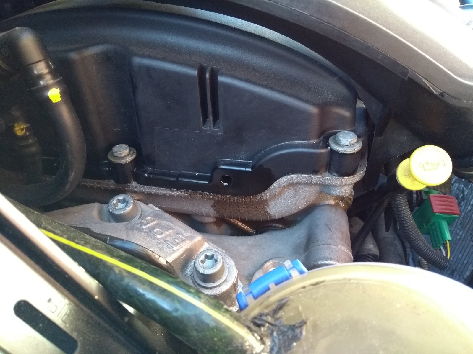

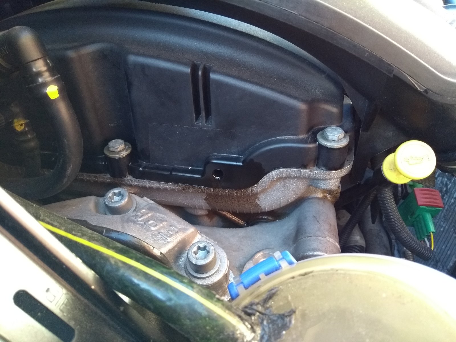

On to the oil leak. The first obvious source of oil was the camshaft cover. Note that the oil appeared to be coming from a hole in the side. I washed away all the visible oil with brake cleaner and a day later it looked just the same.
Today I took the cover off and it seems to be a blind hole. Maybe there is a pinhole defect allowing oil to escape, but I could not see it. I filled the external hole with silicone and reassembled, and no sign of an oil leak there now.
I need to take off the under tray and wash the bottom end to look for any other leaks.

I have had to revisit some of last year's repairs. The oil weep from the top cover came back, and I decided that it was due to a compressed and slightly mis-sphaped rubber gasket around the cover. I put a bit of silicone sealant behind the rubber gasket, and that seems to have held for a week.

I took the top engine cover off a while back to seal up an oil weep with some silicone, that fixed that leak, but it is now weeping a little at the other end of the top cover. I suppose that I should invest in a new gasket.
