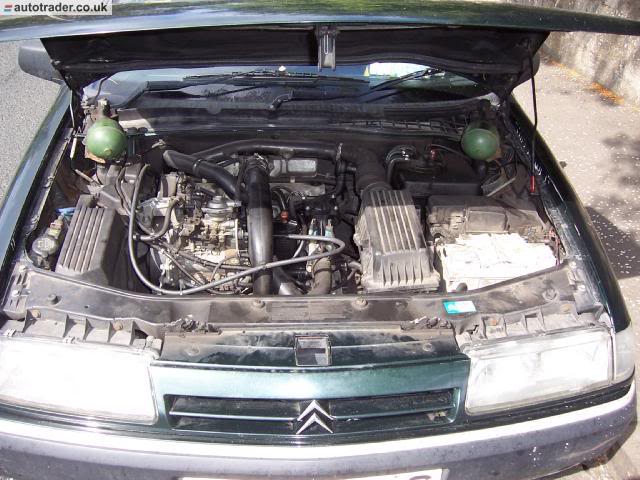

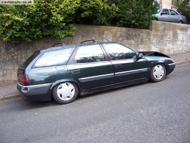

http://tinyurl.com/ry52w
1995 CITROEN XANTIA 1.9 TD LX 5dr Diesel Estate for 150 quid...
160,000 miles, Spares or repair due to front suspension mounts failure (suspension is otherwise fine). remote central, deadlocking, keycode ignition, PAS, elect. windows & roof, roof bars, tow bar, engine in great conditions starts & runs well. Bonnett & front struts damaged rest of car good condition. £150. ono
Telephone: 0797 6186965 or 0141 5616308
Yep, with a PAIR of stuffed struts - a pair!!??
WONDER HOW THEY MANAGED THAT ONE!! :shock: a 'traffic calming' speed bump? Think I'd have been apoplectic...
Cheap car with the rare sunroof on an estate option too.
Andrew

mezuk04 wrote:If one of the suspension struts did fail, exactly what would be the list of jobs and replacements that would be required to get it back to original state?
Replacements are the straightforward part of the job. I didn't say easy, straightforward!! Finding the green bonnet is a good trick if it's the darker one - I've been looking for one for my Xantia for over a year now... :(
The struts are either new from the local Citroen stealer, or good secondhand ones from anything between a fiver to 30-40 quid - any more and you may as well pay the new price.
In truth with a pair of struts and a few tools you could go and buy this estate and fix it there and drive it home - may have to bend the bonnet a bit over a stout piece of timber so you can close it and see where you're driving... :wink:
Andrew
WONDER HOW HOW MANAGED THAT ONE!! :shock: a 'traffic calming' speed bump? Think I'd have been apoplectic...

Unread post by RichardW »
Good effort that one - it's done BOTH sides!!! Must have been flat spheres over a big hump at 40 mph :lol:

Unread post by dnsey »
I wonder if the owner can claim compensation from the Council - I believe that there are regulations governing the 'steepness' of speed bumps.
