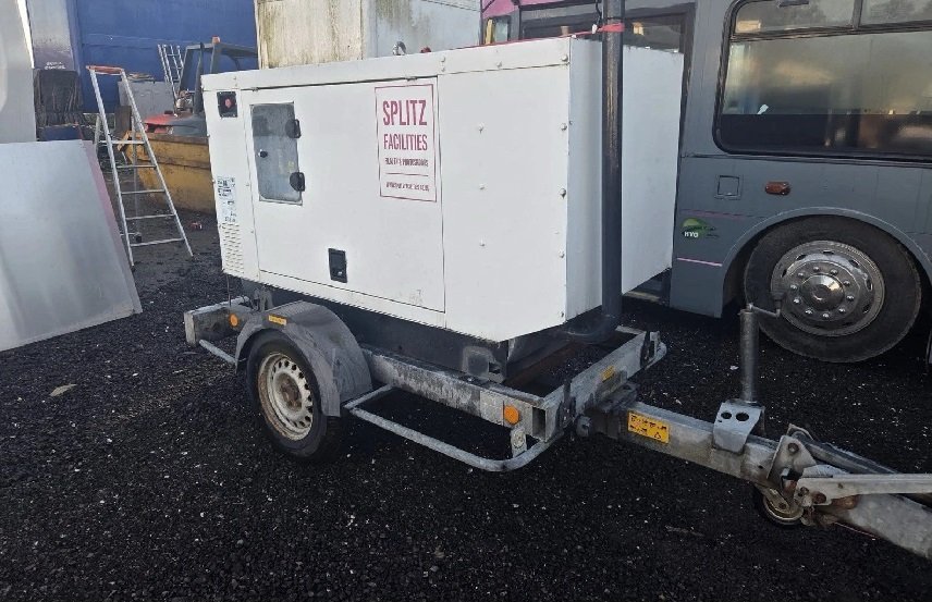

Is this how you would go long distances in Australia using an electric car ? Is towing a generator more energy efficient than having a diesel car ?
Long term though if garages stop selling diesel how will people who use generators manage such as those doing outside welding. Many places use generators as a back up electricity supply.
