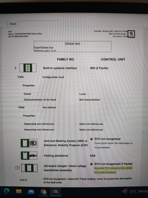

I Purchased a cloned Lexia device and used diagbox 9.68 to scan for error codes. I got a couple, but im not really sure what they mean or if they would affect the Chademo charger. They were F303, F9A0 and P1C17.
I have attatched the diagnostic report. Does anyone know if the codes could account for the charging problems Im experiencing?

There looks like there's some issues with lack of communication with some systems - is you VCI a full chip version? There are cheaper versions of clones that don't have al the hardware on the boards and won't read some ECUs, so that may be a possibility. But in either case, I doubt there's much I can help with, this being an electric motor. They really need specialist attention.
