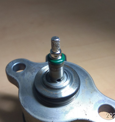

Started stripping down today and the filter on the high pressure regulator has a lot of filings on it.
Can I clean these off?
Would this indicate the failure of the lift pump in the tank which I have now replaced or would it point to the hp pump to which the regulator is attached?
Is there a way to check the HP pump itself?
