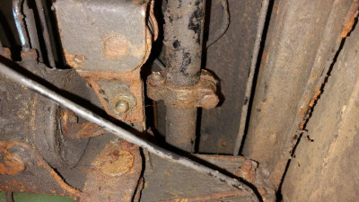

Thanks for responses, it is simple but not that simple.
Have now got under my Xantia and yep the dogbone is missing, but also the 2nd nipple on the arm of the clamp (Rear height corrector link rod clamp and arm) is also missing, snapped off probably.
Part is detailed as Part number 4 in the following detail: I also have some pics of it in place and off the car. Have been trying to source the part new from anywhere, not having much luck.

I believe that breakage of the height corrector arm may be associated with the cradle mechanism that holds the height corrector valve being seized (which is very common at the rear end of Xantias).

Cheers for responses, you right about the cradle mechanism, it was a bit stiff, was planning to wirebrush the area and wd40 the cradle to improve the mechanism, when I fit the clamp.

We managed to find a Xantia being scrapped for parts in North Wales, and have received a box of bits for £20, including 3 dog bones & rear clamps, and the front and rear cradles, all in good condition.
Have now fitted the new dogbone & clamp and the ride height on the back adjusted nicely.
