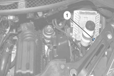

No, that's your ABS Block!
Ok, so this is your actual power steering pump (the part marked as '1'). It is an electro pump on your model:
So what I would do next is to check the level of fluid in the power steering reservoir. (make sure it is clearly marked as the power steering one, not the brake fluid). The type of fluid is specific. It must be LDS fluid - nothing else on this type of pump.
Make sure it is between the min and max. levels.
Next you can try the bleeding procedure:
Make sure you are on level flat ground.
Start the car and leave it idling for 3 minutes. Don't turn the steering wheel during this period.
Next, work the steering slowly, going from lock to lock in both directions, about ten times.
Then switch the engine off and re-check the level of fluid and top up if necessary.
Re-fit the cap to the reservoir.
See if this helps any.

Where's that hidden on the C8 Marc ?
Man is, by nature, a lazy beast, he does not need twice encouraging to do nothing.
- Posts: 37456
- x 5743
Re: C8 power Steering just stopped working.
It's inside the front left bumper area:
To get to it you need to:
Remove:
Remove:
Remove:
- The air filter box
- The securing bolt (1)
Remove:
- The front left-hand wheel
- The front left-hand splash-shield
- The air duct

GiveMeABreak wrote: ↑20 Apr 2019, 13:26 No, that's your ABS Block!

Sorry to appear a moron but when you said, in an earlier post, the pump is on the "left", do you mean (as I suspect) my left as I am sitting behind the steering wheel or my left as I am facing the car from the front, with the bonnet up?
Please see attachments, below.

The passenger side, so yes the left as when you are sitting inside the vehicle.
