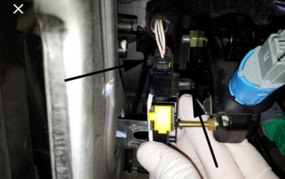

Hi. My car originally had no cruise control but the cruise light is amber when entering secret menu which made me think that cc is in there somewhere.
I changed the squib on the steering column and added the cruise rocker switch on the dash.
The only issue now is that the accelerator is not a 2 step pedal just standard but it's the clutch pedal I'm bothered about. There are two switches. One is plugged in and the one on the side isn't and I can't find the plug for it.
The image isn't my pedal but has exactly the same switches and I'm not sure what they do. Any info is appreciated.
