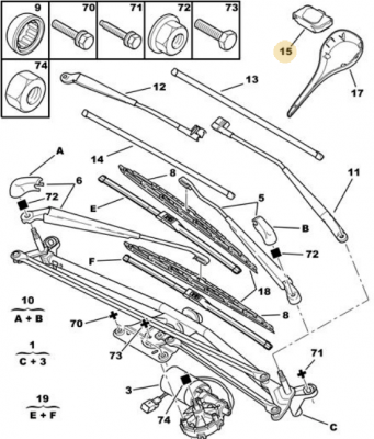

- Posts: 37459
- x 5743
Re: Xsara Picasso rain sensor
The sensor is part number 6405Y5, number 15 on the diagram: currently priced at £284.23 inc. VAT at the dealer.
I haven't seen many on the bay of evil so maybe your best bet is to try a scrappy. There was only one part number for these, so that helps narrow it down a bit.
Sometimes when the windscreen is replaced, the fitter don't realise how expensive or sensitive these things are and leave them dangling with weight on the ribbon cables and this can damage them.
It happened to me after I had my C5 X7 windscreen replaced - but knowing of the issues, I rang the company up and demanded they cough up the cost of the sensor and that I would refit it myself. They did - covered under their insurance. Once the sensor is removed, the gel can also become cloudy and contaminated that also can affect the light getting through for accurate readings and such. I had to have the guy back to test it first - and I told him that putting a bucket of water over it is not the same as it working with light rain - as these have at least 16 speed settings! Anyway job done, but an expensive little thing to change.
