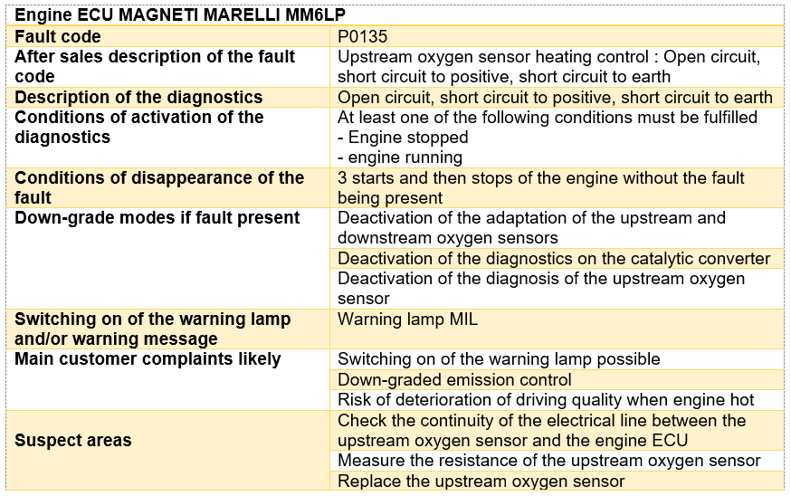

Given the number of faults here - I suspect this is more likely to be more an electrical issue - possibly a connection to the Engine ECU or an earthing issue / Engine Fuse Box module.
To get all these injector issues at the same time, along with oxygen sensors and the coil problems all at the same time is suspicious.
The faults I have are similar to your patrolman, but these are officially the Citroen ones - unfortunately for the year, some faults don't go into as much detail as others, as you can see:
The other issue is how many of these are current - ideally, getting it on a Lexia would allow clearing of any historical codes and re-running a test to pick up current faults.
You say you had the engine fuse box replaced - and the starter motor - to me that is the first suspect place to look. Was this done at a third part garage or the dealer? It won't be the first time that we've heard of issues happening shortly after repairs of this nature. The suspect items are electrical connections not being put back properly - or nicked / kinked cables, pins from connectors pulled out / not making contact, connectors loose, missing (not put back), or earth cables.

GiveMeABreak wrote: ↑11 Oct 2018, 13:38 Given the number of faults here - I suspect this is more likely to be more an electrical issue - possibly a connection to the Engine ECU or an earthing issue / Engine Fuse Box module.
