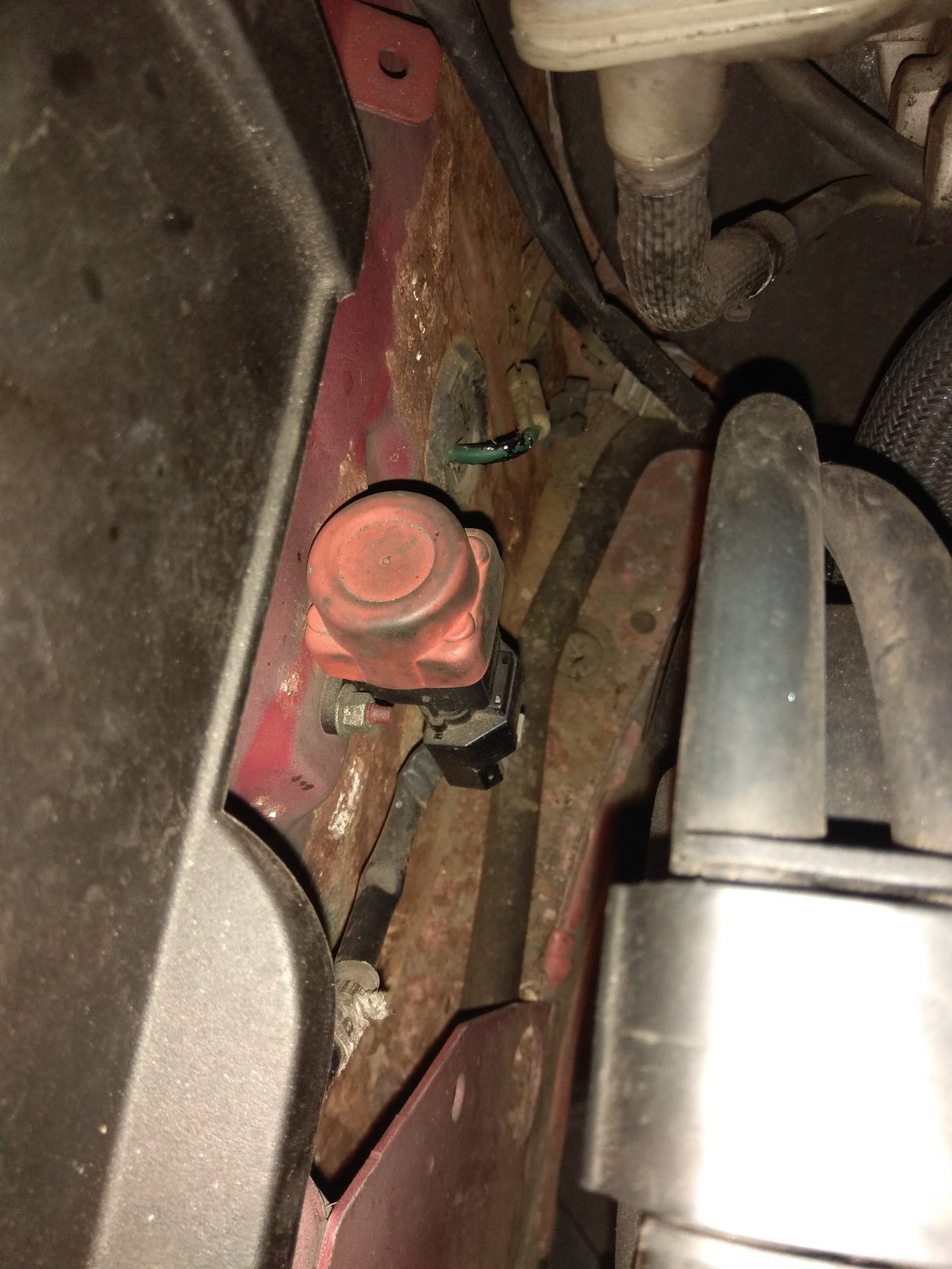

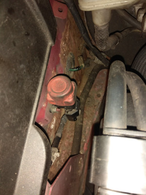

Was looking at my car to see if I could determine where a vibration would be coming from and noticed this rust inside the engine bay.
It is close to where the strut is mounted.
Is this a big problem for the integrity of the car or can it be fixed? If so, what would be required to fix it in terms or work?

If you can't put a screwdriver through it, just get in with a wire wheel, brush or whatever. Then treat with rust eater, prime and paint.

seconded!
But do it soon.
It won't take long for that to dissolve into thin air, especially with all the salt water it's most likely been exposed to in recent weeks, thanks to the frosty weather

"Third-ed"! Definitely lay into it with some sort of abrasive, wire wheel/flap disc & knock all the heavy stuff off, treat with a rust killer solution, then either prime/paint body colur if you care about looks or cover with a good layer of hammerite and underseal otherwise.
Would be prudent to pull the arch liners out and check on the underside as well, even if there's no corrosion there's likely a couple of good handfuls of perma-damp salty mud/gunge up behind them waiting for a stone chip on the end of the sill.
