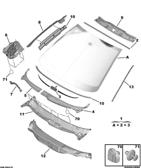

Here are the diagrams of the wiper assembly and the area showing the scuttle - which might help you with removal
Click to Zoom Diagrams
