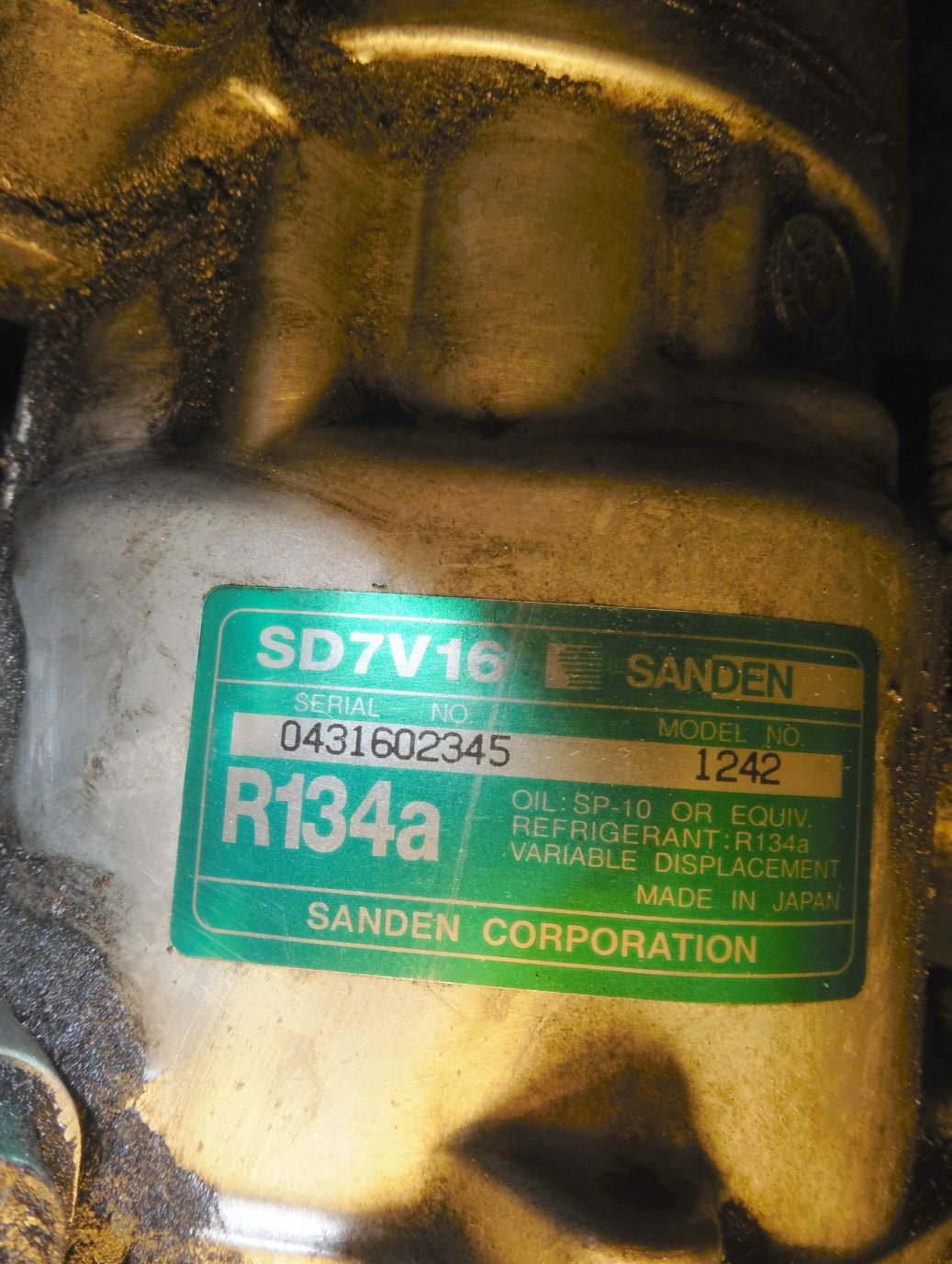

Having just looked up the pump details online type SD7V16 it says it is a refrigerant pump ?
This looks as though the car unknown to us has air conditioning : )
The steering pump then is the smaller one at the top visible while looking under the bonnet ?
I looked online and the compressor has oil in it
It never ceases to surprise me how much I do not know : )
Whether the leak is compressor oil or hydraulic fluid I shall have to check.

That's the air conditioning pump. All c5's have air con (even the base LX).
That pump is unlikely to be leaking any fluid (the system basically has only gas in it) so if there's something leaking from that, it's more likely dripped onto it from above, first. My guess would be an oil leak from something on that side of the engine near the top (Cam cover etc) or just where someone made a mess topping up the oil.

There is oil in the compressor as it had a recommended type on its label sp10, a bit like a fridge compressor I suppose it runs in oil.

Spiff, that R134a is the refrigerant to be used in this compressor. When it is re-gassed properly using a machine, they usually add a quantity of oil to the system as well.

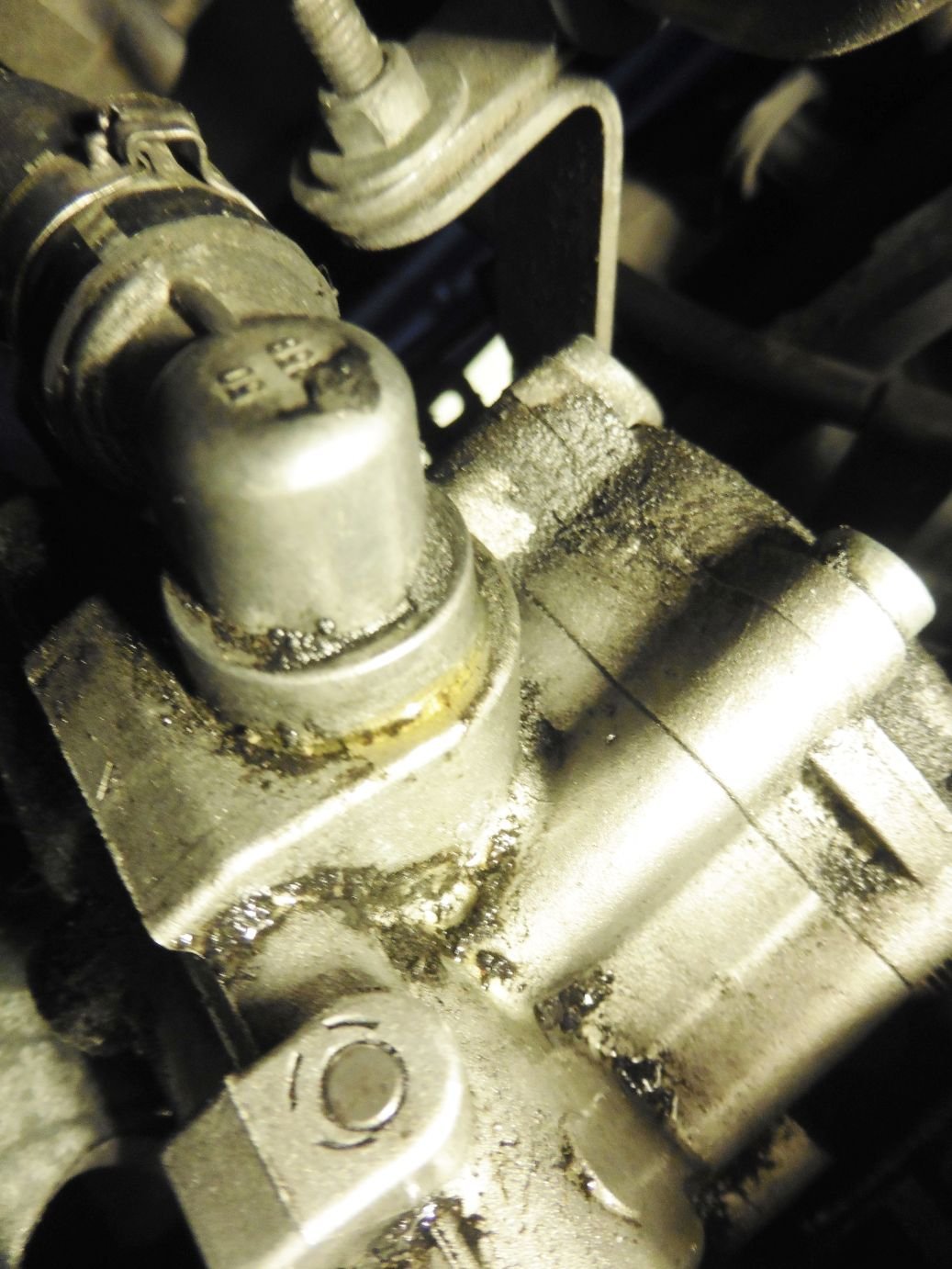

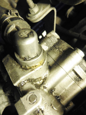

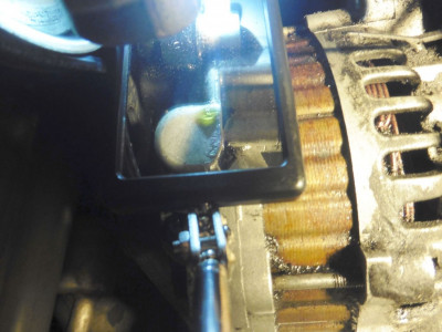

The snow has stopped so I had another look with a mirror on a stick, it has a nice bright built in LED.
It shows under the steering pump it looks to be the source, but exactly where on the pump it is coming from I am not sure.
There is a lot more fluid around apart from the drip, but it does not show up in the image very well.
The alternator has always looked as though oil has been leaking on it, way before the puddle appeared.
It could be it has been leaking for some time and just got a lot worse : )
The top of the pump is dry.

The leak is from the join shown circled in the image, it keeps seeping out even with the engine off as can be seen just after cleaning it off.
I have ruffed it up and applied Araldite, you never know : )

Yesterday I used Araldite but there was pressure in the system.
Today I chipped it off then released the pressure cap and knocked the metal in round the leak, then applied some fresh Araldite.
