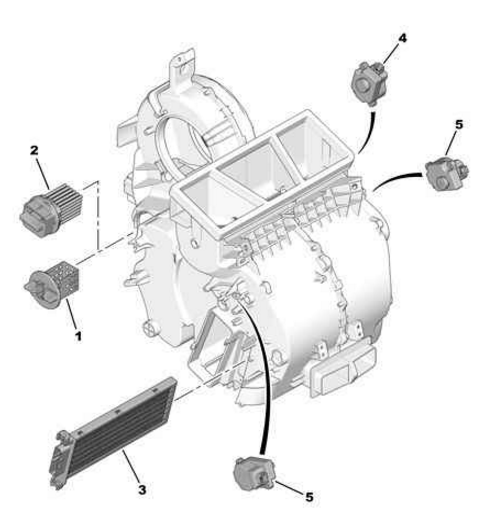

- Posts: 37465
- x 5748
Re: C4 heater/air con not working
Ok Justin, you have the single Air Conditioning System, so in the diagram below, you will only have parts 1 and 3:
Parts 2, 4 & 5 are only for the Automatic A/C System.
(1) Heater Control Resistor
(3) Air Heating Resistance
- Posts: 9
- Joined: 08 Nov 2017, 16:34
- x 1
Thank you GiveMeABreak. Do you perhaps have a wiring diagram of the air conditioner/Blower, front control panel and how they're interconnected with the fuse boxes, as I'm completely stumped as to what's wrong.
I've confirmed the following;
-Resistance over the various coils on the resistor.(1 on your attached diagram)
-That the blower motor works by connecting it directly to the battery.
-There's 12v going into the fan/ac control panel.
-I've manually bridged the 12v connection/plug at the back of the control panel to simulate the adjusting of the fan speed dial. (Still no signs of life)
Is there something I'm missing or over looking?
Thank you again.
Thank you again.
