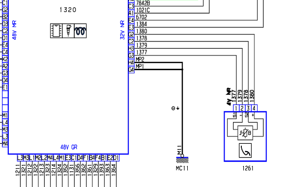

Re: 407 Cruise control
No on this one the Accelerator pedal potentiometer connects directly to the Engine ECU which controls everything thus:
1261: is the Accelerator Pedal
1320: is the engine ECU
The 4 pin Black plug on the accelerator has the following 4 wires:
1377: Accelerator pedal 1 position info
1378: Accelerator pedal 2 position info
1379: accelerator pedal position earth
1380: + 5 volt accelerator pedal position indicator power supply
Might be worth checking the connections are ok on the connector. There were a few TSBs released for this engine (DW10BTED4) with the Siemens Injection system, but I don't have these I'm afraid - mostly to do with stalling / cold starting / cutting out issues.

- x 1746
The injection/engine ECU - which incorporates the CC - relies on the gearbox speed (distance) sensor to tell it what speed the vehicle is moving at. Possible that the distance sensor is faulty/bad connection, not an uncommon fault. A clue is sometimes the speedo (often driven from the same sensor) not being stable.
Vehicles with CC and auto boxes can seem to behave oddly if the box changes gear while the CC is attempting to put on speed. Have noticed that some Inj-ECU-operated CCs will call for "full throttle" if CC is resumed with it set to a much higher speed - the car can be in quite a hurry to achieve the higher speed. If an auto box is in the mix too, it can get quite exciting!
If the throttle pot is simply a two-track potentiometer, you should be able to test it for smooth action
with a test meter, either unplugged on resistance, or connected on the output voltages from each track.
Do any road tests on evenness of acceleration with the box manually selected for a single gear, to knock out the effect of gear shifts; think you're doing this anyway.
