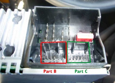

Re: Replacement Radio Citroen C5
You will need to plug the CD connector cable from the APPS2CAR unit into the part marked 'C' in the picture:
