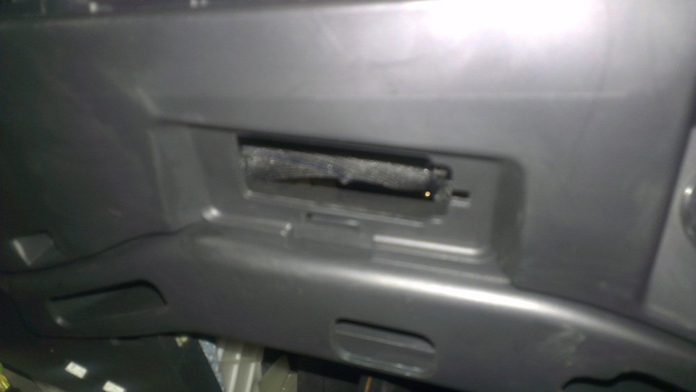

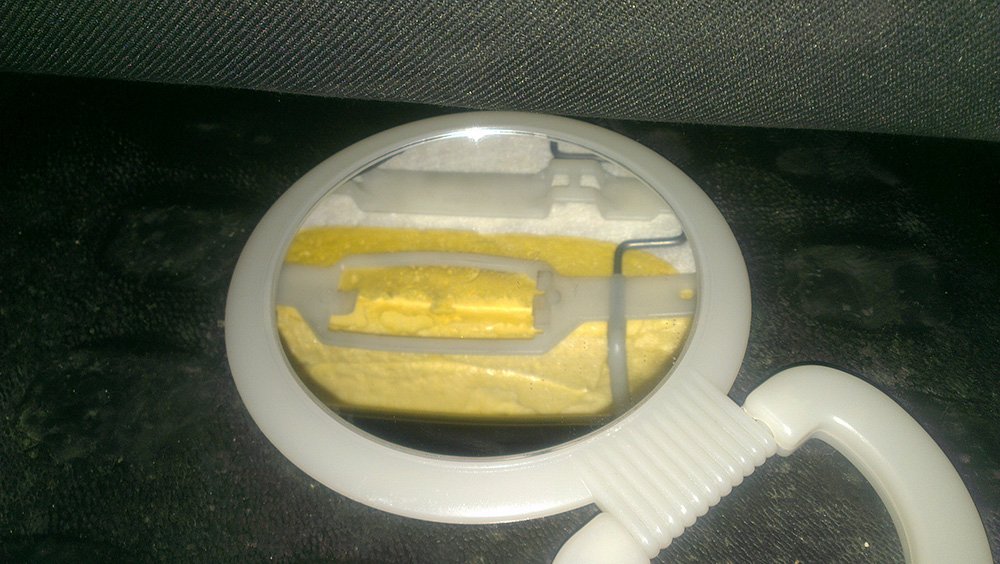

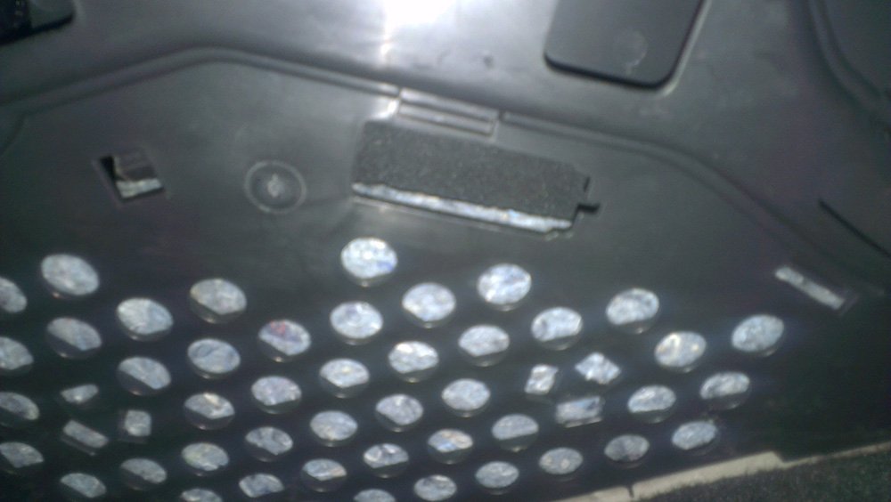

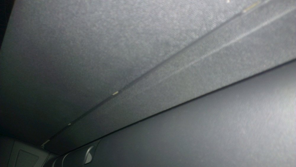

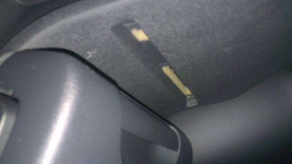

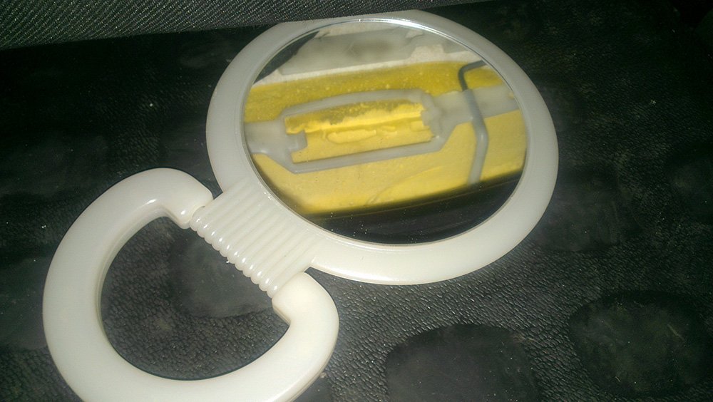

Anyways, back on the main topic ... the lighting ... maybe some of you are wondering what the (... place the word of your choice ...) I'm talking about ...
... here's the current situation on my car (and I'd say 90% of the total C5's that are rolling now on the streets) ... there are holes in the car, and I'd like to fill them with lights ... original, of course, I have access to the Citroen Service Box, and I've done my research, very thoroughly, on this matter (and several others of my interest) ... the positions (and potential end result) are as follows:
[ambient light strip, under the main console, two parts (driver & passenger) ... it should turn on along with the ceiling orange spot lights, with the option of turning them off, by the switch that is placed opposite the CHECK button, across the wheel, the 2nd group of buttons]
(driver's side, left hand wheel position) (passenger's side) [floor lighting, it should turn on along with the pavement lighting]
(driver's feet, placed directly above the brake pedal) (passenger's feet) (passenger behind the driver, photo taken with the help of the mirror) (passenger behind the front passenger) Yes, the front seats have an option for floor lighting for the rear passengers' feet ... didn't know that one until today, while checking out the schematics of the front seat in detail ...
P.S. sorry for slightly blurry images, taken at night, and by doing yoga moves around the seats ...

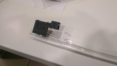

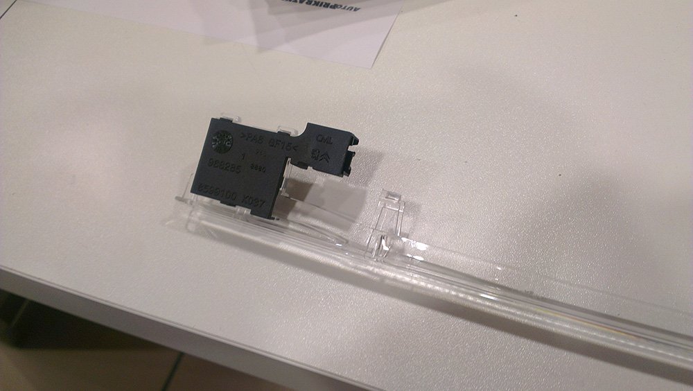

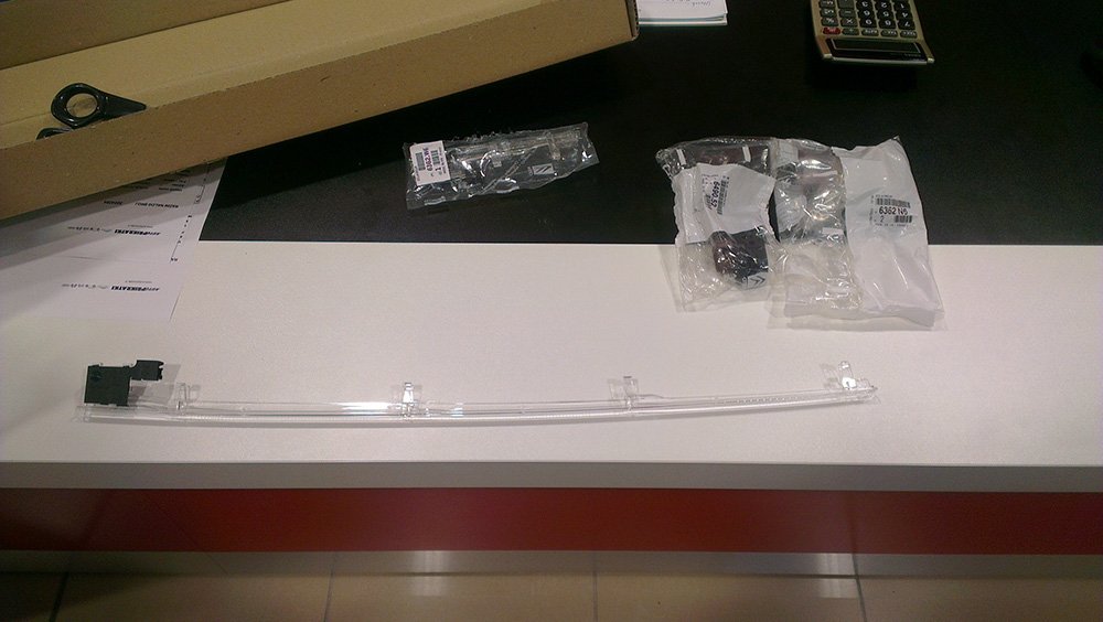

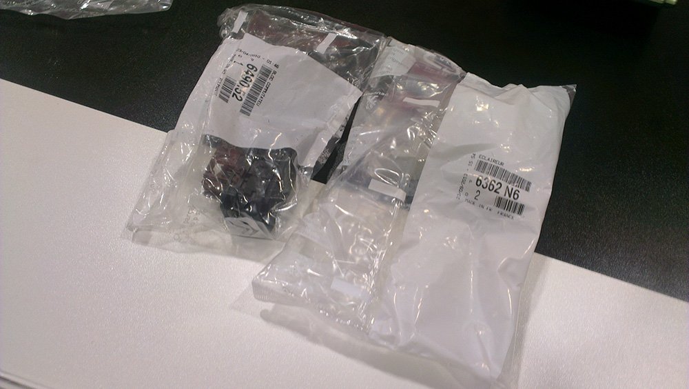

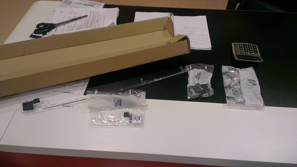

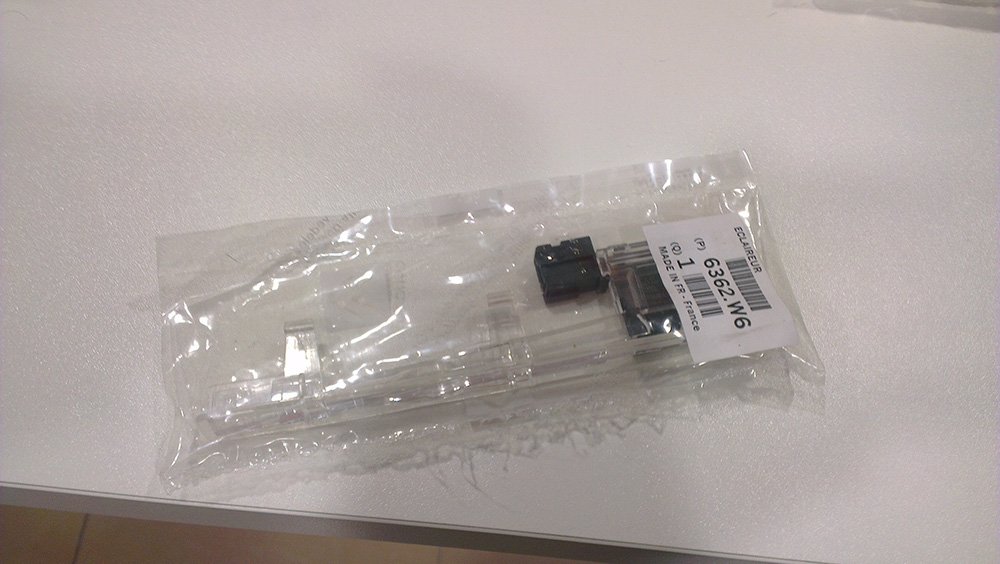

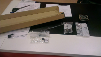

Just dropped off the car at the C.Service to be played with .. here are the ambient lights, the longer one is the passenger's side (unpacked), and the shorter one on the driver's side (still packed) ... not exactly how I've imagined it, I didn't really expect such quality of the items, i thought of it as a simple led strip or sth like that ... this looks more sturdy and of higher quality any way you look at it.
Other packed pouches contain the leg & seat lights and the ambient light switch module which will replace the existing blank one on the dashboard. Of course, the standard W5W lights will be replaced from the start with the Philips BlueVision ultra ones, to match all the other interior bulbs.
