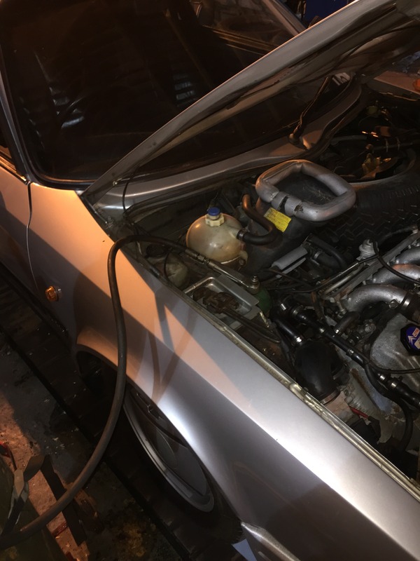

Well I decided I'd recharge all the spheres on the CX this weekend so I got myself a cylinder of Nitrogen from Air Products this afternoon.
One side of the regulator shows the pressure in the bottle, the other side shows it in the sphere:
To pressurise the sphere you open the big black tap on the bottom of the regulator that you can see in the first picture. This lets the gas into the sphere. The instructions say you add 3 bar to the pressure required. When you've reached the desired pressure you wait for 1 minute for the sphere to be pressurised. Once a minute it up you close the black tap. I was recharging an accumulator which should be 62 bar so I topped the sphere up to 65 bar.
The brass screw on the side is used to reduce the pressure in the sphere to the correct level:
Once you've set the pressure you tighten the valve onto the sphere and release the charging rig and put a green cap over the end of the sphere.
The instructions for the recharging rig state "NEVER RECHARGE A SPHERE WITH LESS THEN 15 BAR OF PRESSURE". The accumulator that came off the CX was reading 8 bar so I threw it away. I went through the massive pile of old spheres I've got and found the accumulator sphere I took off my Xantia Activa last year. When testing that it was at 45 bar. After checking, all accumulator spheres are the same so I recharged that one and fitted it back to the CX.
The pump now sounds much happier and the regulator is now ticking every 30 seconds again rather then every 3 seconds before. Will try and get the rest of the CX spheres done this weekend and then the two XM's and Xantia at some point. I noticed that one of my old spheres in a box has a recharging plug on it. The instructions say they are only to be used once though so not sure if it's worth recovering or not.

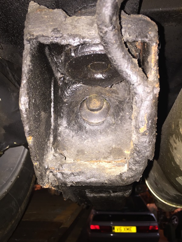

Once these two were done I moved onto the front spheres. Whilst removing the bung from the top of the sphere with a pair of stilsons the sphere on the passenger side loosened from the strut top so I removed the sphere and pressure tested it. The front sphere was at 55 bar and should have been at 75 bar so I recharged that one, the drivers side sphere I did in situ without removing.
The rear spheres can't be done in situ as there's no room for the tool to seal around the charging port on the sphere. Removing the rear spheres looks like a whole lot of fun :(
Will have a look at removing them from the car tomorrow and then that's all the spheres recharged. After that and once the welding has been done the car is finished. The only thing it then needs prior to hitting the tarmac properly is a set of tyres. That's going to be painful.
