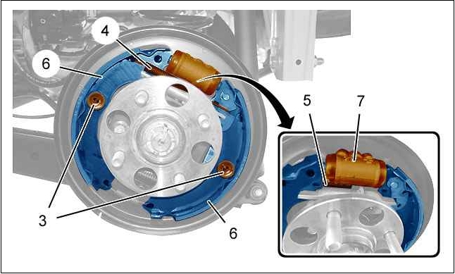

I think the shoes are in the correct way 'round.

The shoes can't be inadvertently mixed up because the handbrake lever is attached to one of them. Although the handbrake lever can be removed from the shoe after removing a (difficult to remove!) clip, there is no post on the other shoe for the lever to go on to the wrong shoe.

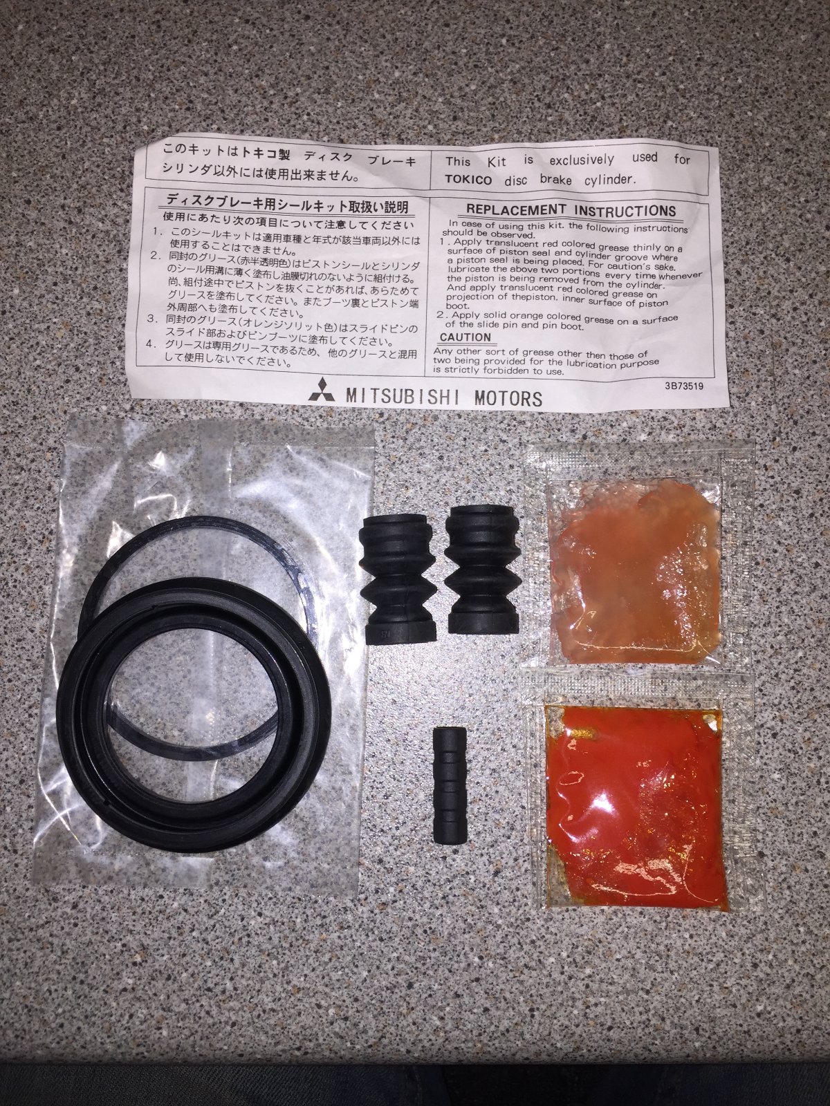

So I got the "caliper repair kits" today, these include new seals for the piston (which I won't be using, but will be saving!) as well as new boots for the caliper pins and the infamous rubber bushing that goes over the bottom sleeve:
I wasn't expecting it to come with grease but it did! Two types. According to the instructions the translucent red grease is for the piston and the solid orange grease is for the slide pins. Only problem is to my eyes its the orange grease that looks transparent and the red one that looks solid, so I don't know which one I should be using. Confusing!!
Then there is the fact that I've already bought a tube of Permatex 20353 which is a high temperature, blue silicone based grease specifically designed for brake caliper slide pins which I was planning to use.
I like the look and consistency of the permatex stuff, I'm not so keen on the provided grease which looks and feels more like tomato sauce...
Given that I can't positively confirm which of the two provided greases I should use due to ambiguity in the description I think I'll just use the Permatex and save the other ones with the piston seals for a rainy day!
I think I know what the rubber bushing that goes over the bottom slide pin is for now - anti-squeal. The last week or so with this small rubber bush left out the front brakes have both been squealing like a banshee!! I don't think I've ever heard disc brakes squeal so much. Both calipers are also rattling a lot over broken surfaces which is to be expected when I had to leave the rubber bush out, and I also deliberately didn't put any grease on the pins - as I didn't have the right stuff at the time so didn't want to contaminate it further after cleaning it out.
If it's fine tomorrow I think I'll be out fitting the rubber bush and silicone grease to the slide pins snow or no snow as I can't take the embarrassment of a loud squeal at every stop in the city centre much longer...

Translucent red grease for the piston may be our old friend, red rubber grease, which is veg oil base I think.

Yes but which one - the top one or bottom one!

After comparing the supplied red grease and the Permatex stuff I had previously bought (which turns out to be green not blue as I originally said) I decided to use the Permatex, mainly because the Permatex is somewhat sticky/clingy whereas the red grease is not sticky, and I felt that it would stay in place better. I also wanted to put a reasonable amount in to stop the pins and therefore the calipers rattling as they rattle a lot when they're not greased.

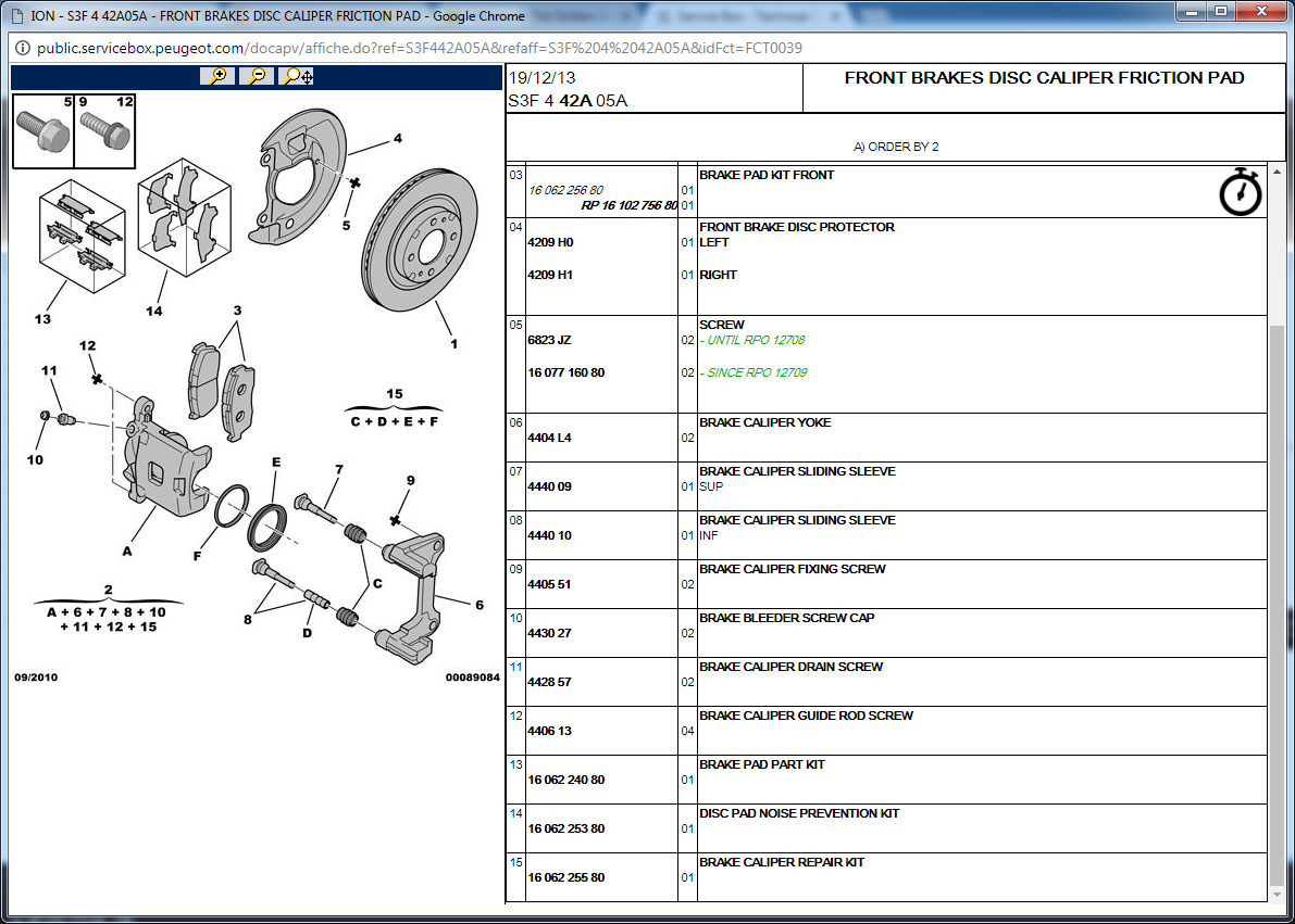

There were/are no anti-squeal shims fitted, nor bias shims. Just piston and caliper fingers directly onto pad backs.
There is actually an optional "Disc pad noise prevention kit"
I did consider getting this back in the beginning but decided against it due to the cost as it isn't cheap, and I had no inkling that it might be needed as it is clearly optional and not original factory fit. (I believe it's made by a 3rd party even though Peugeot stock it)
