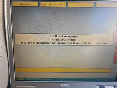

Coding replacement RT3 - cant find ECU in lexia

Its an RT3 with MP3 function to give it the proper name (HDD etc) . Yes its properly wired up inc the dev cable. It was working till i switched something off (and yes ofc, you warned me). I`ll go take a new photo

Almost - it was working in another vehicle, went to put it in mine - again screen was working, went to code it in , changed something and its gone toes up - utterly my fault i know.

Ok, no worries all sorted now, but what I need is a page by page screenshot of the current configuration pages of the RT3, so I can see the option and the setting.
Also, please confirm you have the Colour version and not the monochrome version of the RT3.

Its colour, software version is 6.63 . Taking photos shortly in diabox

Screen one. Should not have hands free kit with telematics unit.
Screen 2 RADIO - this should be set to absent with a telematics unit IIRC. This should only be active for standard RD4 radios.
Screen 9 - Deflation Detection should be present for your 3.0 litre.
Parking assistance should be active Front & Rear.
Aux Video input - suspect this should be missing.

no deflation - 3 of the 4 sensors went bad so i had them all removed, yes i can put new ones.
radio now remvoed , hands free now removed
parking assist has dodgy wiring at the front somewhere i think, so doesnt work anyway
aux input now off

Holy Thread resurrection - as a final note, sent bsi/ecu and keys off to be reflashed and paired to a chap in wales and voila, solved the problem. Lesson learnt
