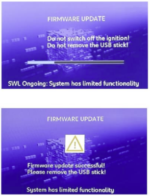

So it is normal to get the blue screen with limited functionality when it is updating - are you sure you are not getting these messages?
If something else, then I suggest you take it directly to Citroen. Your vehicle is still under manufacturer's warranty.
DO NOT tell them you have connected it up to a diagnostic or provide any faults - or they may use this as a reason to decline any repairs. They do specify that this is for dealer diagnostics only.
I suggest you book it in and tell them you have been trying to update the system software and / or maps unsuccessfully and are getting the relevant error screens. Leave it to them to deal with the issues. It won't cost you anything ad the telematics are under warranty. They will perform their own guided diagnostics and depending on the results may end up replacing the head unit and or the screen, depending on the outcome of the tests.
