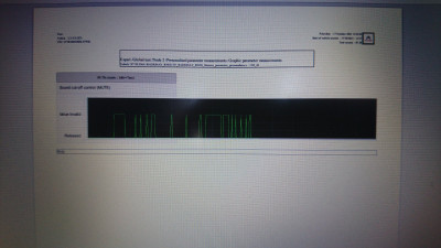

i have done a Global Test and for once no issues reported so thats a big plus
I have done the actuator tests hopefully the images will upload but no way to test the blue tooth module Think i am looking at a replacement head unit hopefully the info on the second photo can determine which unit i am looking for
Colin

Re: I Phone issues with MyWay / WIPNAV
So looks like there is a fault with the muting as shown on the pictures which would explain why you can't be heard by the other callers.

I have had to change the battery today on the car as it refused to start so have actually managed to do a BSI reset and the special menu reboot.
However still in exactly the same position regarding the phone
But i have done another actuator test on the RNEG system, i will upload the pics via my phone then come back and explain what i did although no improvement I have tried pressing both +/- volume controls on the steering wheel and when i do this the head unit mutes the sound, not sure if it is meant to but it does.
Mute button works every time on and off and both volume controls work as they should.
However in the above pic when i press the mute button i get invalid value, but you can see from the timeline that both +/- buttons affect the mute button.
When i press the - button i get a pressed response from the mute button, yet when i press the + button i get an invalid response from the mute button.
Not sure if this is something that is head unit related or actually a fault with the steering wheel controls.

- Posts: 37742
- x 5807
Very nice battery!
Yes, definitely some fault showing up there with the mute test showing invalid value. So there is also a Mute function on the Head Unit. It's actually the Power Off button top left. A short press turns it on and off, but a long press pauses a CD if playing, or Mutes Radio. But the dedicated Mute button also on the head unit may be faulty.
A difficult one this as it is interfering with communications. That unit I linked to has gone now - did you buy it anyway?
