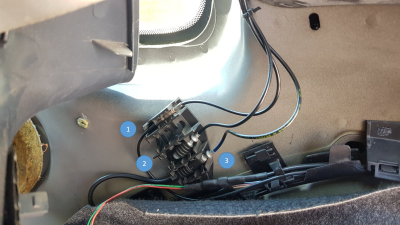

These right here are the connections from the aerial. This is after I removed the existing aerial cables and ran the original clio cable through.

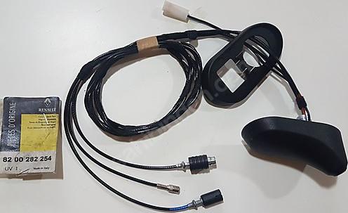

So for the aftermarket satnav in the 182 there's the aerial on the roof that has 3 connections as below.

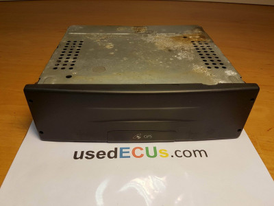

This is the standard aerial that comes on the clio without the satnav unit In the boot there is the a GPS unit with the CD, then under the drivers seat is another GPS telematics unit, then you have the screen that's in the dashboard itself. The only unit that the radio aerial passes through is the one under the drivers seat, which I have since removed.
Is it likely I will have to swap out the aerial base to a standard clio unit? Seems strange that the GPS one wouldn't have the capability of FM.

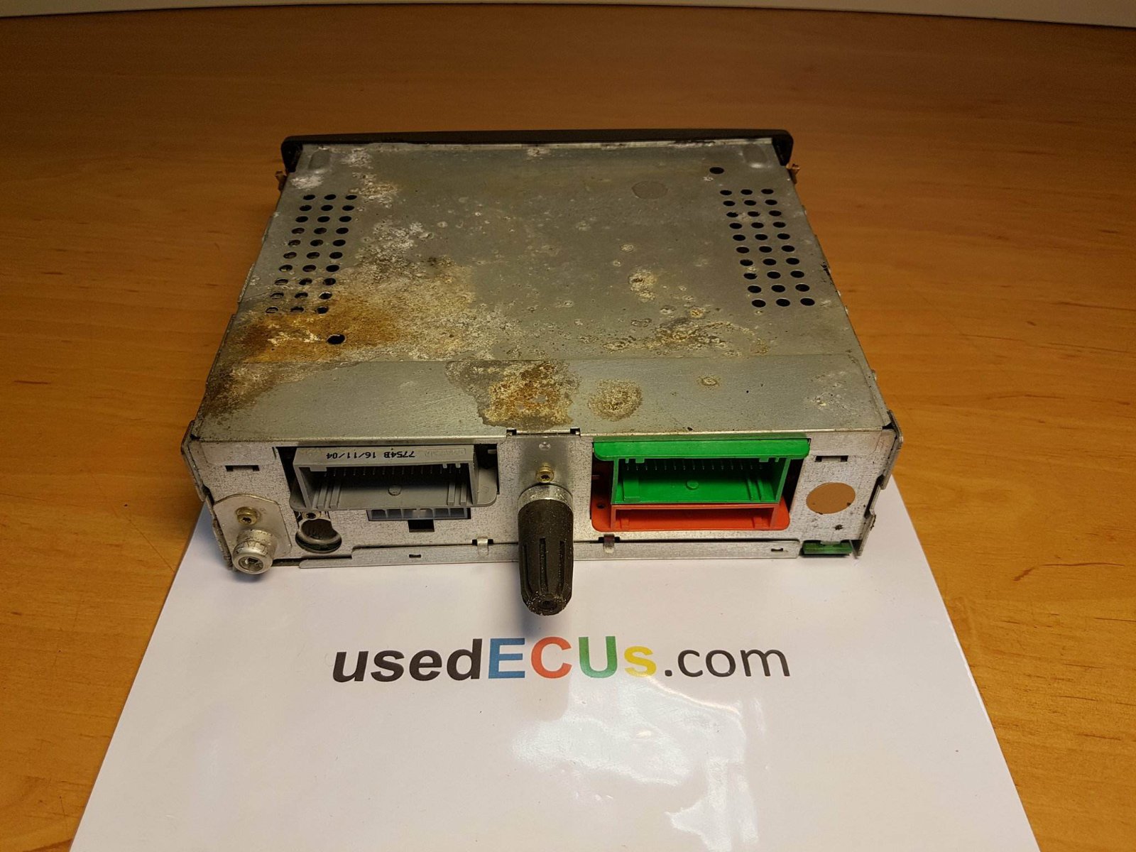

This is the same unit that I removed from under the seat. Can see a radio cable in, and radio cable out on the back.

Is it as simple as me having these wired incorrectly? Is #2 the FM aerial? The only issue being it wouldn't be a straight connection to the aerial cable.

The only way you'll know is to trace #2 back to where it originates.
