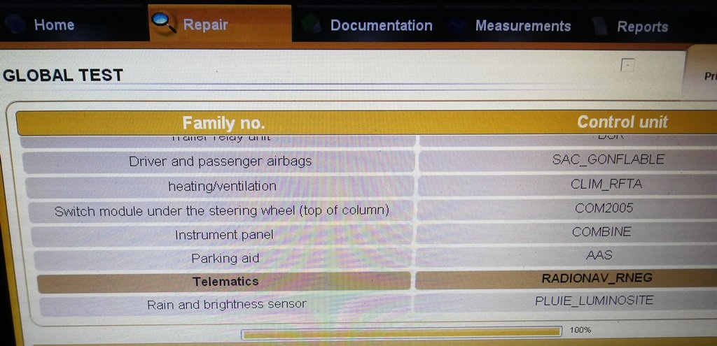

Re: RNEG - trip computer
There are some options I cannot see - these are usually found when you go onto the RNEG ECU from the Global Test and then into the manual configuration. You have some of the options shown in the BSI, but I can't see the others.
One observation on the data that I have -
"Geographic area of use of the radio" - you have 'SPACE 0' and my data says it should read (Europe). Has this been changed?
The other thing my data says is that the "Heating/ Ventilation" setting should be 'Absent', where you have it set to 'Dual Zone Air Conditioning'. Sometimes this does not mean you do not have it - but that it is not supposed to be set here. You might want to try and change these 2 options back to the values the document I have says and see if that makes a difference.

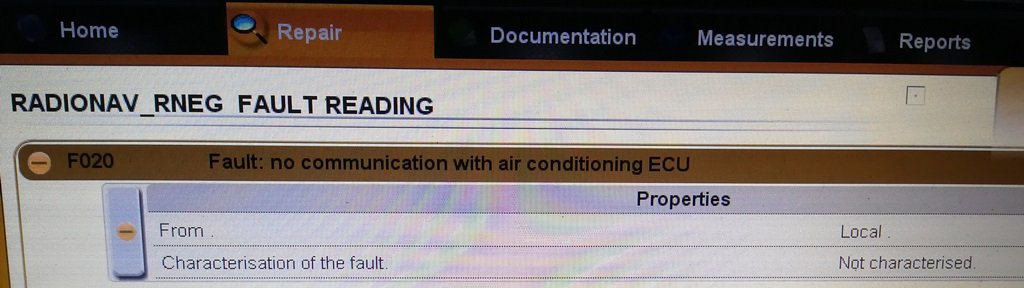

The 'Heating / Ventilation' error code F020 may also be because this part is not configured correctly:
Also try a BSI reset: follow my procedure here:
BSI Reset / Battery Disconnect / Reconnect Procedure
Never disconnect the quad lock connector from the RNEG before disconnecting the battery (but you must follow the procedure in the link) and again when connecting it back again.
ECU of radio-navigation RNEG | |
Fault code | F020 |
After sales description of the fault code | Fault no communication with the air conditioning ECU: Not characterised |
Description of the diagnostics | No reception by the BSI of data originating from the air conditioning ECU on the Low Speed Comfort CAN for 2,4 s |
Conditions of activation of the diagnostics | Engine running Air conditioning ECU configured present in the BSI |
Conditions of disappearance of the fault | Reception of the data originating from the air conditioning ECU by the BSI on the Low Speed Comfort CAN for 2,4 s Air conditioning ECU configured present in the BSI |
Down-grade modes if fault present | Display of dashes in place of temperature |
Switching on of the warning lamp and/or warning message | - |
Main customer complaints likely | Downgraded display of the information related to the air-conditioning |
Suspect areas | Air conditioning ECU CAN + electrical supply Air conditioning ECU earth Air conditioning ECU Low Speed Comfort CAN harness Air conditioning ECU Built-in systems interface Electrical harness |

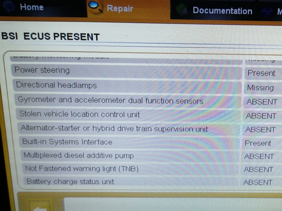

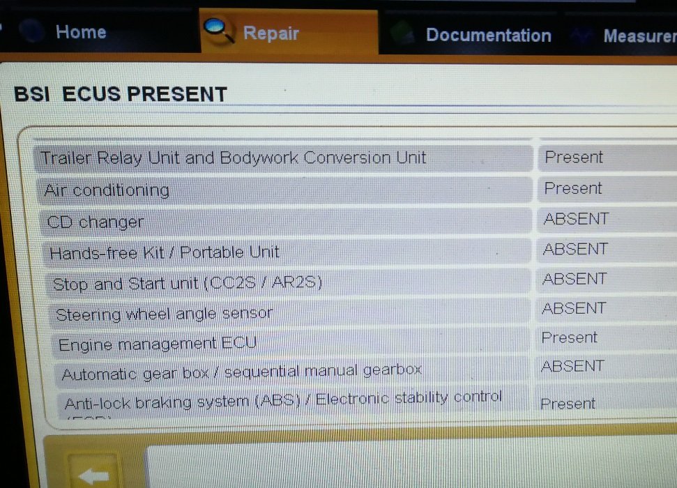

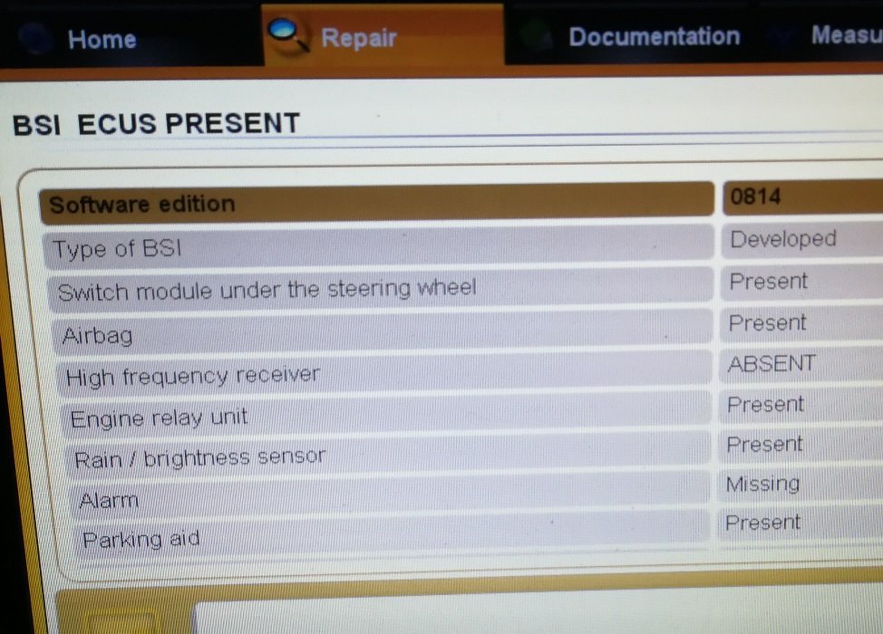

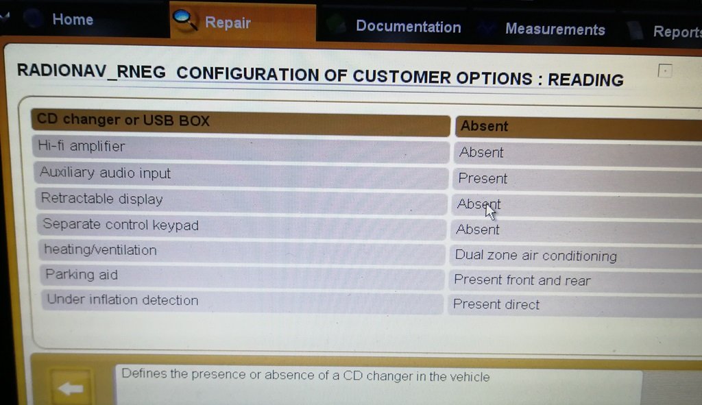

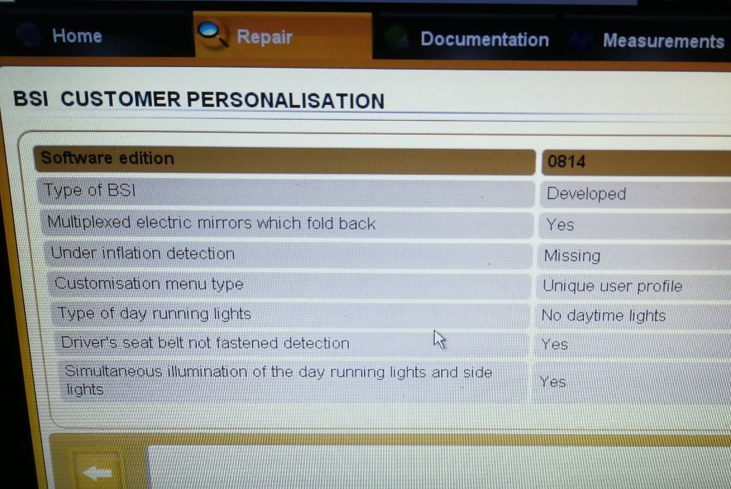

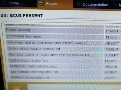

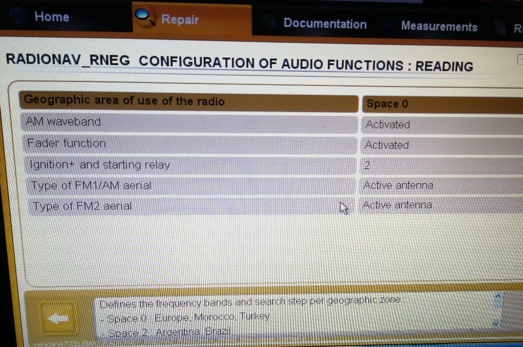

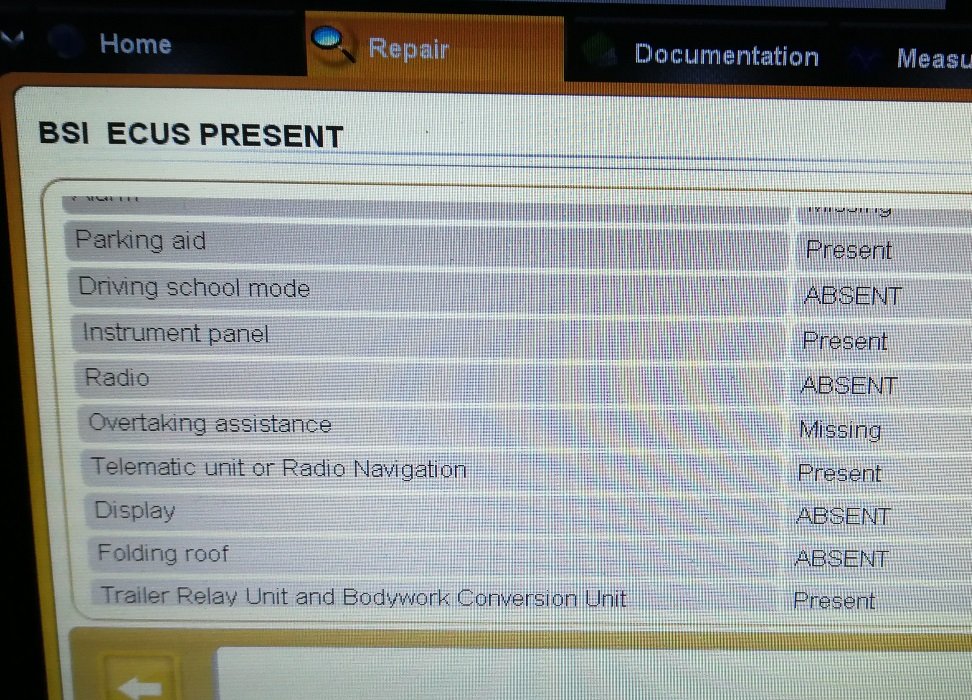

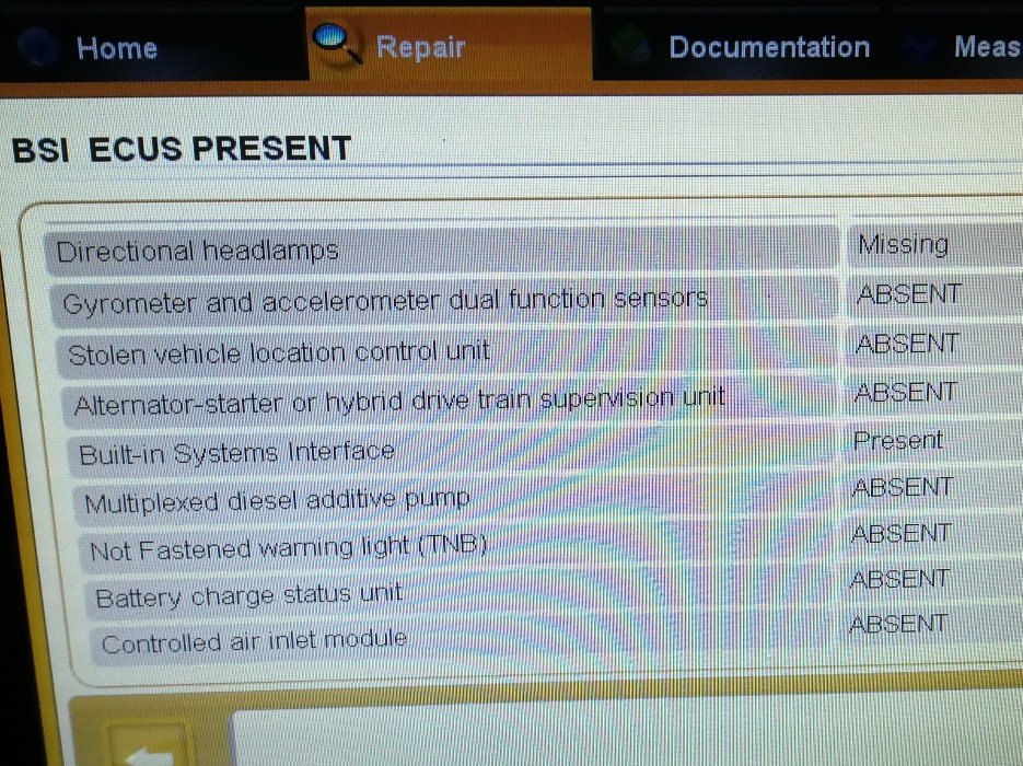

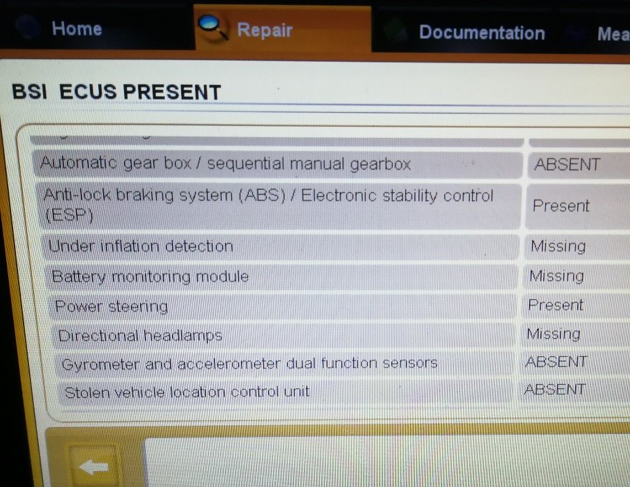

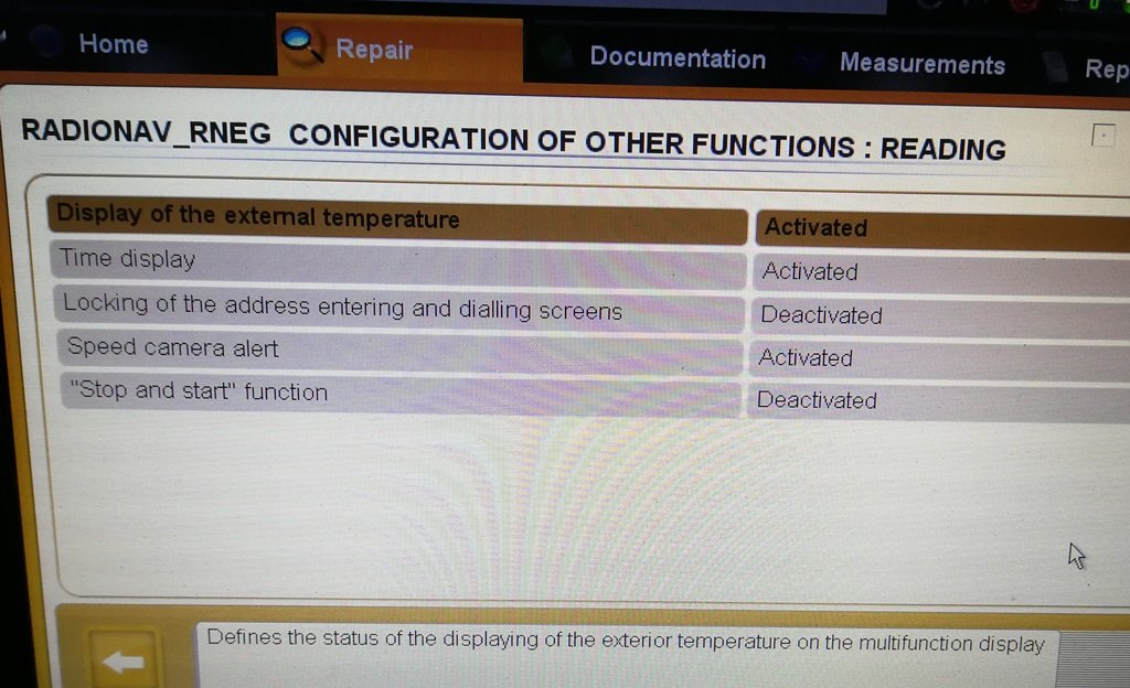

Sorry for the late reply,
Are these the missing options?
I have 'SPACE 0", I can set SPACE 0, SPACE 2, SPACE 3 and SPACE4, but only SPACE 0 is for Europa. I haven't been changed this.
I can set 'Missing', 'Single zone air conditiong' and 'Dual zone air conditioning'. I set this parameter to 'Missing'. The error F020 (No communication with air conditioning ECU) has disappeared in RADIONAV_RNEG fault reading.
Below I attach a few more images with options. Are they set correctly?
Thank you in advance
GiveMeABreak wrote: ↑29 Mar 2019, 10:13 There are some options I cannot see - these are usually found when you go onto the RNEG ECU from the Global Test and then into the manual configuration. You have some of the options shown in the BSI, but I can't see the others.
GiveMeABreak wrote: ↑29 Mar 2019, 10:13 One observation on the data that I have -
GiveMeABreak wrote: ↑29 Mar 2019, 10:13 The other thing my data says is that the "Heating/ Ventilation" setting should be 'Absent', where you have it set to 'Dual Zone Air Conditioning'. Sometimes this does not mean you do not have it - but that it is not supposed to be set here. You might want to try and change these 2 options back to the values the document I have says and see if that makes a difference.
I did it. Unfortunately, there is still no trip computer in RNEG.GiveMeABreak wrote: ↑29 Mar 2019, 10:13 Also try a BSI reset: follow my procedure here:

Ok, so I've had a look this evening and I have an issue with accessing the specific BSI document for your vehicle, so I cannot compare the options against your picture.
I have looked at the ones you highlighted and they appear to be right.
It took longer as I had to copy your pictures into a single document to make it easier to see - as it kept going to your image hosting service! For future reference you know that you can upload images directly on this forum - just go to the full editor and attach the images from your PC.
So without the document specific to your 207 I cannot verify the options.
Another note for future ref - always take screen shots before changing so you can return the values to the originals in case it goes wrong.
I don't know what else to suggest at this point as without the document it's like the blind leading the blind. I can't use a Citroen one as the whole point is that these vehicles display the data differently - so would defeat the objective.
