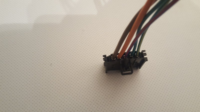

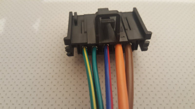

My heater blower was only working on full blast and was told I needed a new heater blower resistor. After examination, the wiring loom to the resistor was also blown.
I bought one from ebay (could be the problem) and thought I could just match up the wires but the wiring seems to be different.
Can anyone lend any knowledge?
I'll upload some pictures

What's throwing me is my van has 4 wires the new loom has 5.
Any advice greatly appreciated

Re: Citroen Relay Blower
Thanks for that Marc but to be honest I'm not really any more the wiser. Going by my pics I was hoping to just cut the wires and crimp in the new loom. Exactly the same black casing on my new one as the old, just the extra wire I cant figure out.
In the van there's a separate live and neutral which plug straight onto the actual blower motor itself
