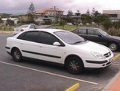

Yes, smallest is 195/65/15 ... like mine.

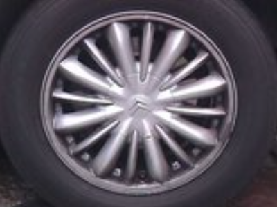

Colgzz What rim is in the picture? I can't find it anywhere.
Clogzz wrote: 16 Oct 2013, 01:08 Yes, smallest is 195/65/15 ... like mine.

Post by Clogzz »
It's a 15 x 6 inch Ronal alloy wheel made in Germany.
I'm in Australia and bought the car second-hand in 2009.
The importer says that it's never had or seen a wheel like that and wasn't an original fitment.
I don't find any photos of it on the internet either.
So, sorry for being of no use.
