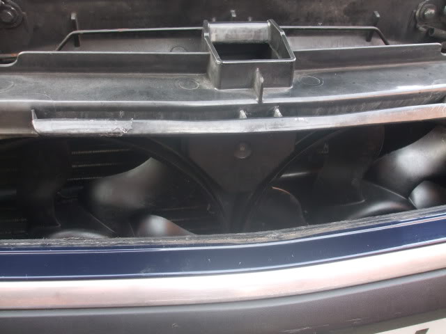

Well with big thanks to Jim and Richard (THANKS GUYS) i checked the fuse under the dash and the feed which showed 12 V and also hooked up number 1 terminal on the thermo switch multiplug to both 2 and 3. 3 clicked a relay but 2 did nothing. Also no fans came on :(
Tracing the clicking relay there is only the top right hand relay point which is working. The 3 relays are all the same so were each tested in that socket and they all clicked so seem ok. Whilst on the phone to Richard it was confirmed that the fan blades should rotate freely when not in use...neither of mine did :( They had a small amount of play in them but certainly did not rotate freely. So i decided they will need to be replaced. Not being sure how to take the fans out and definately not committing to taking the front bumper off i managed to get the fans and motors dissasembled from their housing and removed through the gap between the front grill support panel and the bumper....Rich said it was going to be a knuckle scraper either way and he was right. The right hand fan came off easily enough with the left hand thread screw removed, however the left hand fan screw was stuck in fast and no amount of lube and combination of screwdriver would budge it....so i had to cut a fan blades off to make an access window so i could get at the motor bolts. Then with the aid of a large broom handle and some welly i managed to wrench the assembly out of the front. (Not recommended) No damage was done to any other part of the car and they are going to be replaced so it was a result in my book :wink:
So tomorrow i will make a call to my local second hand Xantia parts guy and if i cant get any motors and x 1 fan blade assembly (the other is ok) then Richard has kindly offered to help me out with some replacement motors :) I will also be replacing the big fuses and probably the relays from a breaker to rule that lot out.
I doubt ill get it back in and running before my trip next weekend but i want to do it right and not rush it so will take my time and get it right.
Some photos for anyone who has never tried to remove these before to show it can be done without removing the front bumper :)
You will see the connection were quite furred up and the motors look past their best :roll:

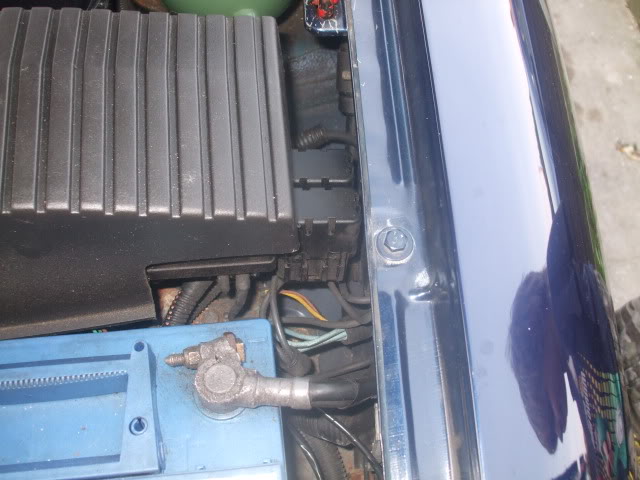

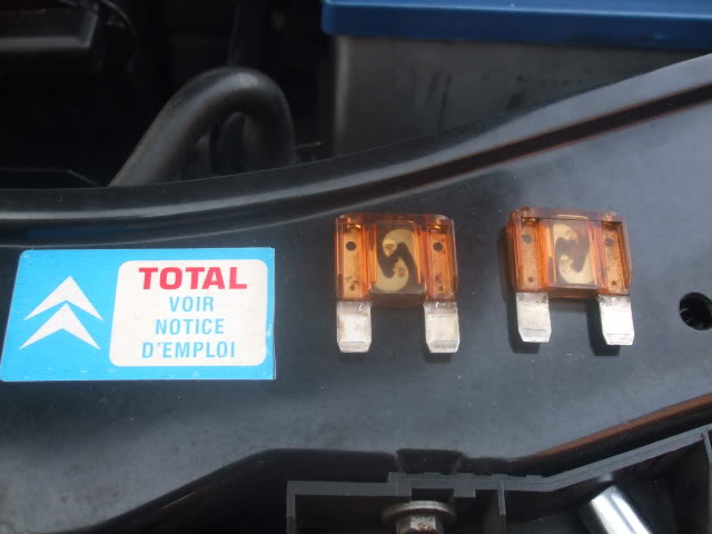

Id obviously made "a booby" by not finding the two big 40A fuses that live by the battery which were both blown before speaking to Richard and realising that my motors were duff and assuming that was the only fault.
The reason i didnt find this before was because i was looking for a 40 amp fuse by the battery controlling the fans and i found one in the fuse tray by the battery (first lower right hand fuse) and that was ok. What i didnt read properly from Jim's advice (hence the booby) was the location of these big fuses underneath the two smooth rectangular covers on the right hand next to the corragated relay/fuse box cover.
The positive i take out of this realisation is that they will have blown through the fact that my old fan motors were seized almost solid :shock: and so these would have needed to be replaced anyway.

Well a quick trip tot eh local ish scrappy this morning and a fair trade was had....£1 for x 3 big 40A fuses.
Popped the two back in place keeping one for a spare in case something went wrong, and hey presto.....fans are back again :D
Both slow speed and high speed working as planned.
Job done :wink:
