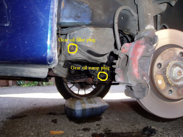

It's more or less in the same place on these, but its on the other end (as in nearer the front of the car, the bigger BE gearbox has it at the back nearer the bulkhead)
There is a plug on the side (a larger headed bolt on the tin end cover) that is the combined filler / level plug.
You've already seen the drain plug underneath anyway. :)
Here is a picture (not mine I just found it) of a 106 which is the same gearbox really...
Andy.

Yep it looks just like that, only there's no filler plug as circled! Honestly I've checked and double checked....
There's not even a blank piece of gearbox casing where a drain plug could go, the casing follows the shape of the tin cover.
Trust me to have a special one!

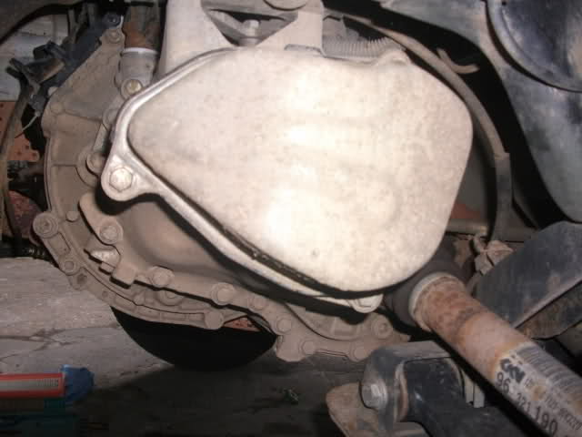

Shot from under the wheel arch showing the tin cover, but no filler

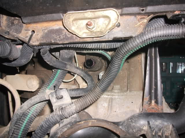

Shot from under the bonnet. I've just found this black pipe, which looks like a filler. There's no dipstick under the cap so I've no idea how you'd check the level, but it looks like you could fill the gearbox through it.
Perhaps I'd have to drain it all out, then fill with a measured amount?

That's exactly the way to do it. Remove the reversing light switch to let the air out as you fill it and it won't 'blow' back. You should have a little black cap that fits loosely on top of that 'pipe' by the way.

that bleck pipe is just the gear box vent/breather, and as the flying clutchman say it shouldheve a push fit cap over it, this is were i fill via but i never feel the need to remove the reversing light switch as i never get blow back,
try removeing the bolt at the front lower end cornner of your tin end cover, it might be a level bung as well as a tin cover retaining bolt,
regards malcolm
