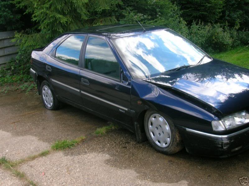

Citroen Xantia Turbo Diesel Spares or Repair 1995 ebay item number: 190138727987
Cheap car for someone if they don't mind undertaking the simple fix...
Mind, no doubt there'll be another one on ebay with a bent bonnet along shortly...

Thanks for the listing Anders - useful reference for sure.
I can only go by personal experience on failures of the strut top,
and have seen firsthand 3 fail (one an Xm) and caught and changed
at least somewhere around a dozen or so of Xm's and Xantiae...
The sad fact is, as these cars aren't valuable in the way a silly German
badged equivalent is, when a strut top fails on one, it goes straight for
scrap or it turns up on ebay as is or being broken for spares.
I used to see quite a few on ebay, but as scrap value is off the scale
now, it's usually weigh in time now!!
Andrew
