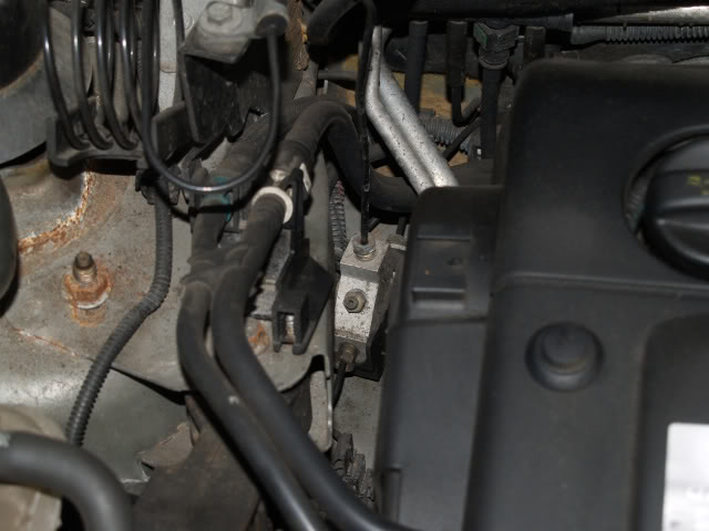

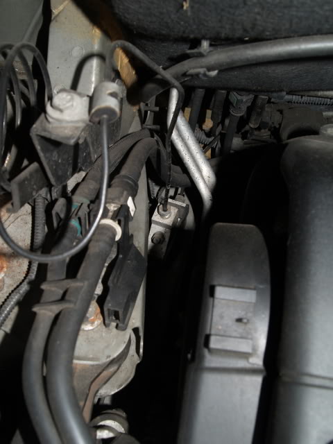

1.Identify the front and rear bleed points on the suspension distribution manifolds.
2 On the front bleed points fit suitable sized bit of pipe other end in waste bucket capable of holding a couple of litres.

- Posts: 28723
- x 5672
I believe that this may be what you mean. It's the only likely looking widget that I can see. Apologies for the delay.cachaciero wrote: It really isn't that difficult I don't have a 2.0 ltr so i am not sure exactly where the front manifold is for the suspension but I think it may be accessible from the top at the back of the engine myglaren would be able to confirm that.
