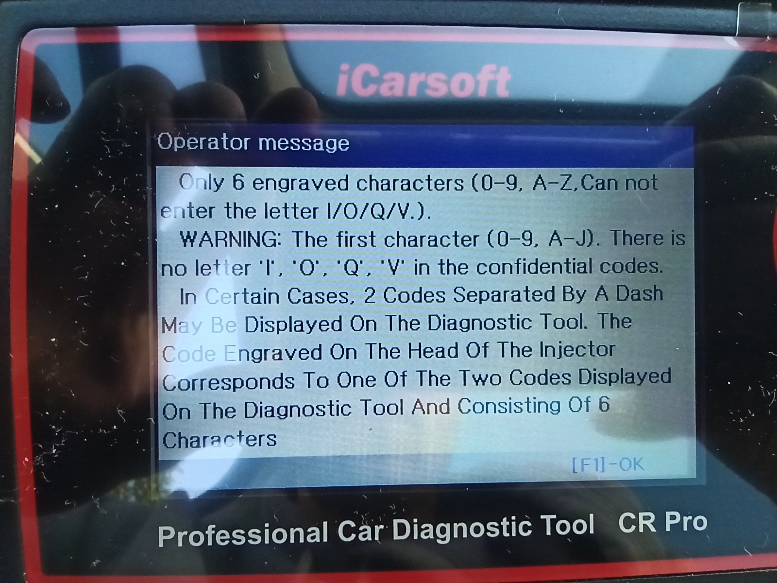

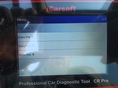

Hello.
Could someone advise me please on the programming injectors for the Peugeot 3008 2011 with ICarsoft CR PRO. The issue is that after I have renewed a new injector, I faced an issue with the Diagnostic tool: "Application failed".
In fact, in the Injector menu I have two options:
1) Classification of injector.
2) Replacement of injector.
If I choose the first option it gives me the ability to enter a code of the injector(not sure which injector code it expects to have from my side, new or old, but I tried with both - the result is the same "Application failed").
The second option looks like more suitable for my purpose, but if I choose that option it gives me a strange description how to program a new injector like: Programming Of The Injectors:Drive The Vehicle To Activate The Programming Conditions:The Engine Coolant Temperature Must Be Higher Than 80 Degree C. The Diesel Injectors Are Programmed Between 2600 And 1600 Rpm, etc.
So I am quite confused as to why I cannot program a new injector, diagnostic tool, car, car ECU...The battery voltage looks good 12.5V.
If anyone can give me advice on it. Thank you!

The first option is to input the code no of the injector. This must be the code from the new injector. Injector 1 is gearbox end. The second option is to force an initialise where the car learns the new injector & adjusts fueling. On some models this happens instantly (1.6 hdi) and on others it happens the next time you drive the car & meet the conditions specified. If you don't initialise your new injector it fuels as per the old unit.
