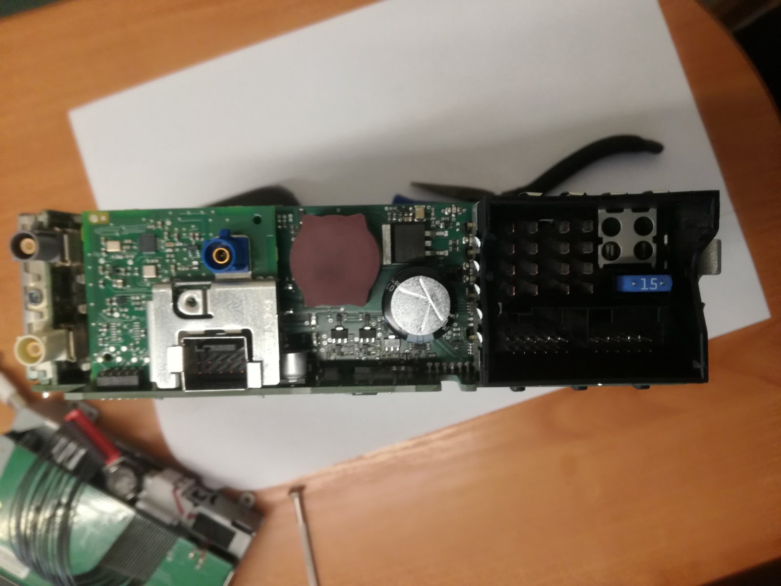

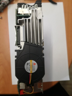

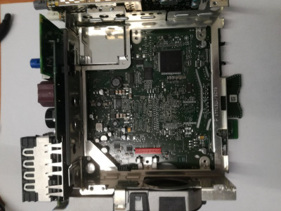

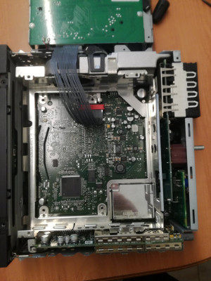

I encountered an obstacle. Can you help me where to find the micro sd card in this headunit?

OK, so we need to rewind a bit here - I've been dealing with similar topics with other members over the last few days and multiple other topics so it gets a bit confusing in the overlap. Of course as you initially posted in the wrong Forum section (RT6 instead of MyWay Forum) it it getting confusing trying to remember your system without re-reading everything again. So I have moved this topic into the MyWay section now.
So of course I was still thinking in RT6 terms when I last responded - but of course the MyWay does not have an internal Micro-SD card at all it has onboard EEPROM flash memory, so there isn't anything you can do regarding swapping parts, sorry!
The only solutions I have seen, short of replacing the unit or sending it off for repair is 're-animating' the system which needs equipment to attach to the motherboard and software which I don't have.
Some bloke was doing the operation as shown here, but he hasn't responded to questions...

I've already figured out that this can only be a motherboard integrated.
