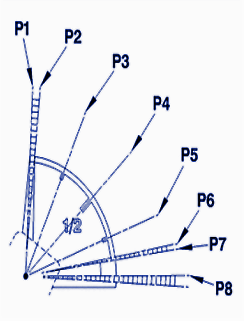

Re: Citroen Xsara Low Fuel Warning
Edit: In light of the VIN I now have - the information I previously posted is different, so I have changed everything to reflect the changes in the year for the 2004 model:
So this is how the fuel gauge information is displayed and not quite as you were told....
When the ignition is switched on:
The instrument panel receives the fuel gauge information and uses a static law (vehicle stopped) to calculate and display the level of fuel.
Whilst Driving:
When speed is greater than 3 km/h, the instrument panel still receives the information from the fuel gauge, but uses a dynamic law to calculate and display the level of fuel.
N.B. : The dynamic law uses the fuel flow information coming from the engine ECU via the CAN network.
Low Fuel Warning:
The instrument panel transmits the min. fuel information to the BSI via the Comfort VAN network.
The BSI then manages:
N.B.: The gauge needle continues to fall, it cannot rise.
N.B.: The alert warning lamp no longer flashes . Once the warning lamp is lit, it remains lit.
N.B.: Take a threshold of 400 ohms to detect an open circuit.
Whilst Driving:
Low Fuel Warning:
- The diffusion of this information on the CAN network
- The control of the audible warning on the Com 2000 (pre-alert sound no. 2)
- The lighting of the warning lamps on the instrument panel
Fuel | Capacity ( litres) | Resistance (ohm) |
Petrol | 7.5 | 255 |
Diesel | 10 | 239 |
Indication | P1 | P2 | P3 | P4 | P5 | P6 | P7 | P8 |
volume ( litres) | 54 | 52 | 41 | 27 | 14 | 11.5 | 9 | 0 |
Resistance (ohm) | 35 | 49 | 104 | 159 | 220 | 231 | 247 | - |
Resistance (ohm) | Full | Full | 75 | 50 | 25 | Lamp Lit | Lamp Lit | Empty |
