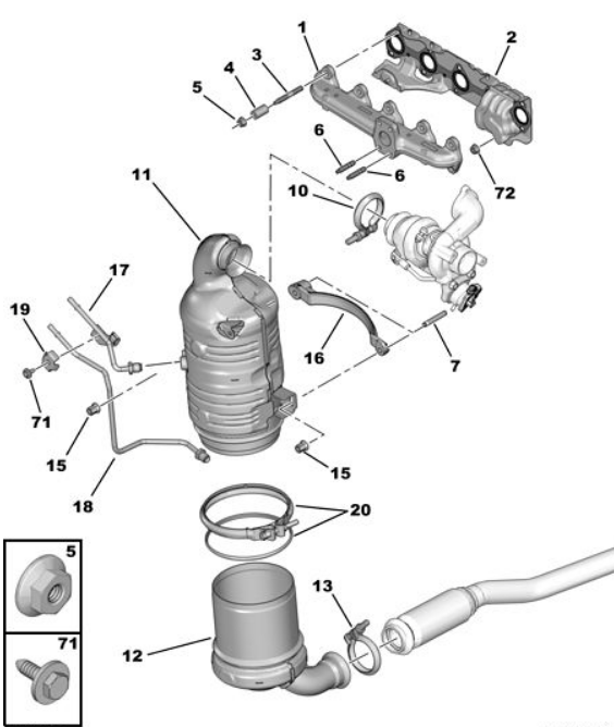

Here are the diagrams I have - just for identification:
Here is the Exhaust Gas Temperature Sensor:
So the EGT sensor would have to go inside there to do its job, like a probe.
Part 17 is the Particle Filter Pressure Pipe (In) Part 18 is the Particle Filter Pressure Pipe (Out) |
1 is the Gas Temperature Sensor 5 is the DPF Differential Pressure Pipe |

Thanks for the diagrams, the issue I have is with the filter/block in my picture.
I can't find reference to it anywhere, to me it seems it should fit in the top of part 11 in your first diagram, however it is loose so actually falls onto the EGT sensor

Appreciate what you are saying - as these are not supposed to be serviced (officially), but replaced, there are no further details. Although yours is different on the C3, this official video shows the system, but if you keep an eye out at about 0.40 on you will see inside and one of the pipes (although hard to see which one) looks attached on the side and the probe is in between the 2 halves on the inside where there is a gap.
So I'm wondering if in the process of removing it, that block has become dislodged at some point and loose.

I've not used them personally - but I forgot the part numbers: Either of the 2 part numbers shown at (12):
9677468180
1606857180
Click to Zoom
