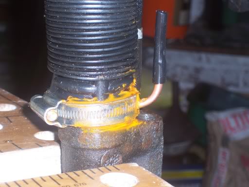

The small rubber leak off pipes on my rams are currently ok, but on my previous Activa they both leaked.
I've thought about applying a protective coating of some sort over the rubber connections to try to increase their life and hopefully ward off the death of the rams.
Maybe a suitable silicone sealant would work. This would keep the elements of salt and rain off the rubber and prevent it from perishing.
On my first Activa the small rubber bleed off pipe appeared to crack away from it's parent rubber base. I modified the front ram as shown in the pic below:-
The orange paste is Hermetite Instant Gasket - Orange RTV Silicone Rubber. Specially formulated to resist oils and transmission fluid. It appeared to seal quite well against LHM.
cheers, Kev

How did you stitch the bend leak-off 3.5mm cupro onto/through the jubilee
Kev or is that not what you did in your repair pictured? Any further info
on the apparently successful repair would be welcome!

Having had a closer look at the leaky front ram I removed recently, the wet
areas of the gaiter are actually NOT the small leak off spur pipe but apparently
from the main bellows ram gaiter. I'm loath to start dissecting it but wonder
if anyone here knows what is actually the likely reason for leakage and it's
subsequent MOT failure?
I'm fascinated to know what you found with your repair Kev!?
Are you out there!!?
Andrew

Unread post by KevMayer »
Hello chaps,
Sorry, I've not been in this part of the forum for a while. I usually go straight to the main Citroen forum. That's set up in my 'favourites'.
The repair shown in this thread worked well and was still holding when I sold the Activa.
The Orange Hermetite seems to hold against the LHM.
I now have a different Activa.
Cheers, Kev
02 plate C5 2.2 Hdi Exclusive SE (now 170k miles 03/21).
Used to have:- Xantia 1.9 TurboD SX. 1996 Blue & 1998 Silver Activa. + 1992 BX TZD Turbo.
KevMayer
Posts: 1051
Joined: 12 Sep 2003, 22:01
x 2
Now I see the question.
Well, I used a piece of domestic 15 mm copper pipe and a piece of small bore copper brake pipe left over from a job I did many years ago.
On the ram the leak off pipe had totally broken away and left a small hole in the rubber collar which runs around the circumference of the ram. So, I cut the 15 mm copper pipe and flattened it out so I had a rectangle of copper just as wide as the jubilee clip and about 15 mm long.
I drilled a hole in this bit of flat copper, just big enough to pass the small bore tube through it.
I drilled a hole in the jubilee clip so it would pass over the small bore copper. But positioned the hole in the jubillee clip to make sure that the screw mechanism of the clip would not get in the way once it was back on the Activa.
I then used plumbing solder and a gas torch to solder the small bore tube into the hole in the copper plate just so about 2mm of the tube stuck through the plate. This 'sticking out' bit would push into the hole in the rubber and help to seal it off.
I then put orange hermetite around the copper but was careful not to get any in the hole of the small copper tubing.
I then placed my soldered copper in position and opened up the jubillee clip, passed it over the small pipe and screwed it up tightly.
A little more orange hermetite and that was it.
The plastic leak off pipe pushed into a piece of small bore rubber tubing to connect it to the copper.
So, beneath the jubillee clip is a soldered copper T joint type thing. It worked ok.
Cheers, Kev
