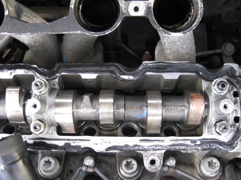

Camshaft cover removed

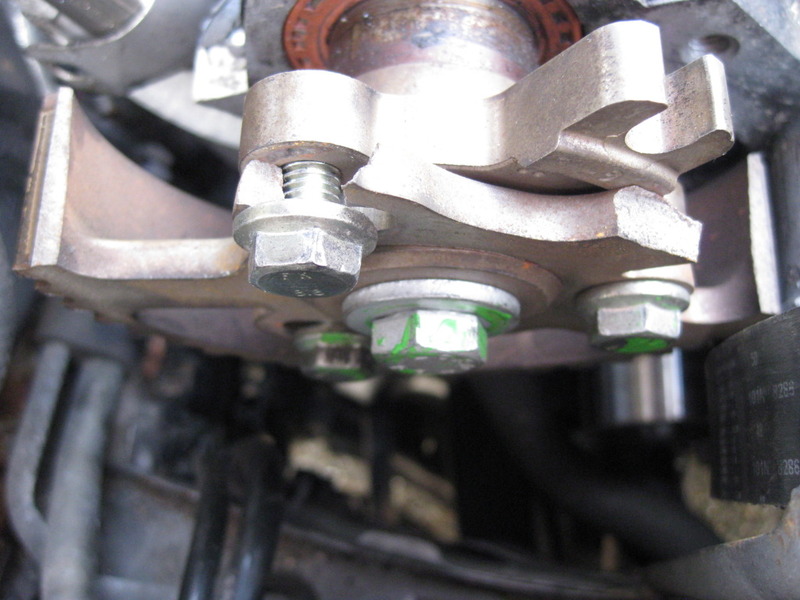

Broken camshaft pulley

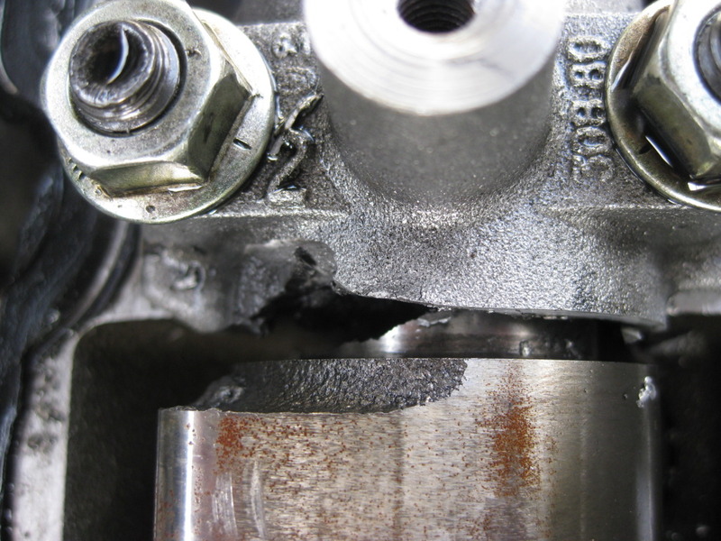

Clean break between caps 2 and 1. Both caps look intact, but cap 2 has a chunk missing on the left had side, also this side of the cap is scored.
Camshaft break on the driven side of cap 2.
The garage told me they could move all sections of the broken cam shaft, but I can't move the centre section under cap 2. It may be the raised valves under the cam lobes holding it tight onto the cap though?

The break on the driven side of cap 2 looks quite different. To me it looks like it's been twisted apart.

In the last job the garage dismantled the cam pulley,camshaft etc etc and after a short while its all broken and the head is destroyed!!and they say "its nothing to do with us", !!*+"!! off!its down to them!!.Trouble is as in all these cases its going to take time.MONEY,and lots of hassle to prove it.
It looks to me that the cam pulley is the cause of the failure.I have dismantled almost every Peugeot engine and never seen a cam pulley broken like that,its impossible to brake under normal running unless something OR SOMEONE has caused it to brake.The camshaft and caps are broken because pistons have hit the valves,that`s normal on this engine after a cam belt failure,but in this case the cam belt has fallen off due to the broken pulley.Its very difficult to comment just by looking at your photo`s.I would say one or more of the three bolts that hold the outer part of the pulley have been left loose?? The center bolt is tight and you loosen the three bolts when fitting the cam belt,adjusting it,and then tighten the three bolts. SO?,don't say anything to the garage,get an expert to check round the debris,particularly these three bolts to see if my theory is correct,or any other cock up that has caused the failure. Its got to be down to them and I hope you get your full compensation,good luck.

I would take the centre cap off and examine it carefully, if it had seized there would be evidence of it. Athough the cambelt was not broken if it had slipped it could cause the drestuction that you have experienced. The cheapest way of dealing with it would be to fit a secondhand head if you can find one, there are some cheap new ones but they come bare so you would have the cost of ressembly, there are a selection here:

Just been outside to have another look... I notice the cam sprocket is right at the end of the slotted holes. Either slipped or been forced round when something seized?Oldpug wrote:I would say one or more of the three bolts that hold the outer part of the pulley have been left loose?? The center bolt is tight and you loosen the three bolts when fitting the cam belt,adjusting it,and then tighten the three bolts.

You should not pull the cambelt off / on without loosing the tensioner, its not an old 8v Vauxhall engine where a lot of people did that.
The three bolts on the cam hub should be roughly in the centre not fully up to one end or the other either. I don't mean spot on centre, just not fully at one end if that makes sense.

I've never seen the cam hub do that either, I have seen on a DW8 (a very early one) the inj pump sprocket break but I've only ever seen it once, possibly was a badly machined one or something, not related to your issue as I say never seen the hub break.

Could the belt have been strong enough to break the sprocket? It looks like its dragged it to the end of the slots and then gone "ping". It was a brand new gates belt, not a crap one.spider wrote:I've never seen the cam hub do that either, I have seen on a DW8 (a very early one) the inj pump sprocket break but I've only ever seen it once, possibly was a badly machined one or something, not related to your issue as I say never seen the hub break.

It looks to me like you could get the middle cap the wrong way around (180 degrees out). And it is the middle cap that look suspect with the way the camshaft has broken next to it on the driven side. The break doesn't look "clean" like the other one either.spider wrote:Oh I meant the wrong way around rather than swapping them, if that makes sense. Then again I've not taken a DW8 apart so not even sure if you can fit them the wrong way around or not...

maybe they cracked the cam sprocket whilst holding it when undoing the center bolt
