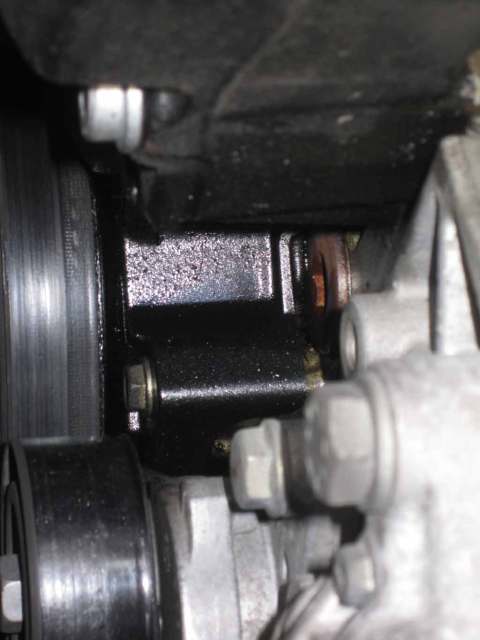

Unfortunately the forum did not allow to upload pics. Here are some photos I uploaded to the TinyPic.
Photos:

Before buying a load of parts it's worth checking the leak isn't coming from the rocker cover gasket or the camshaft oil seal ...in picture 2 I think I can see an oil stain above the head gasket, this may have just got blown there though.

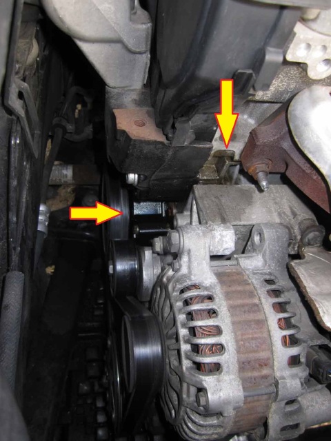

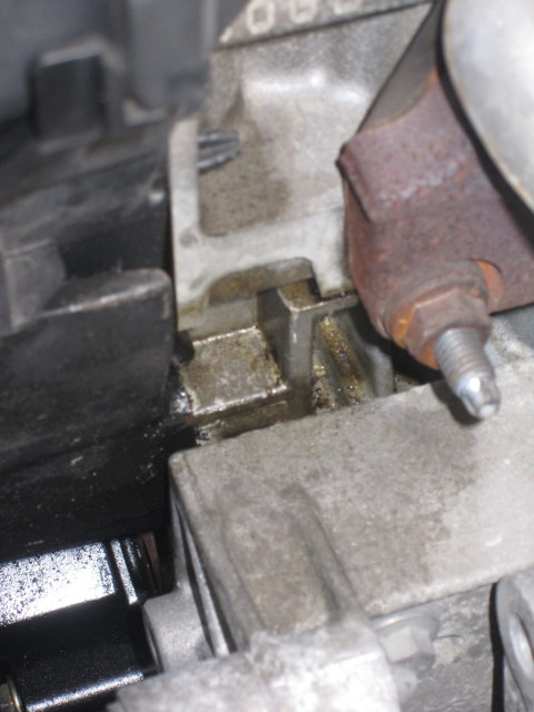

I have exact same problem with oil on same place with C4 2006. 1.4 16V. What was solution in your case?
Please look pics. Red is oil area.
http://oi41.tinypic.com/a1prmh.jpg
http://oi42.tinypic.com/wlr86x.jpg

The solution was head polishing and a new head gasket. (Since I am a friend of c4tobe)
He also changed all the seals including rocker cover gaskets and valve stem seals just to be sure. You can get a full set of all seals and gaskets for a competitive price.

This is a very common problem on the 1.4 petrol 16valbe engine, we replace loads of these, it is nearly always the head gasket, as shown in the pictures.

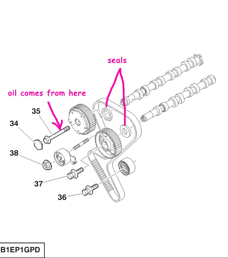

Hi today we removed timing belt to see where oil come from. Ha, this is interesting.
I was assumed that oil comes form camshaft seals. But its totally weird that comes from screw that goes into camshaft. My repairman put some superglue on screw and replace camshaft seals (even old was good) and now there is no any oil coming out anymore. I don't know how much this will keep oil form going out.
Probably better solution will be to make new screw or order original one but i don't know part number.
Thanks to everybody and i hope my problem will help someone in future.
