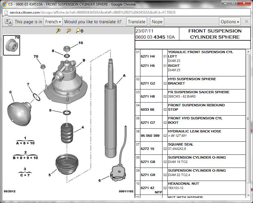

I have a citroen c5 2004 2.0 16v exclusive (6 spheres) and I had a problem with my front right “SUSPENSION SPHERE BRACKET” (item 2 from the image below).
The rubber parts were broken and, after some weeks running this way, LDS started leaking through it… I decided to stop using the car to replace it, when the front suspension stopped elevating… (The LDS leak must be bigger than I previously thought…).
