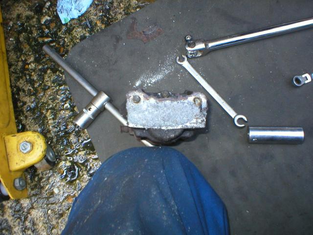

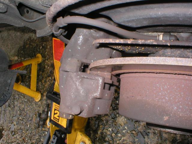

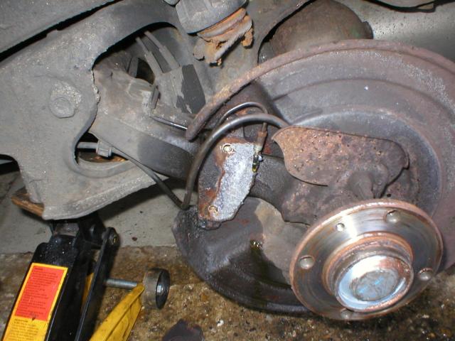

As Paul says, it's a job you need to attack with great care. Wire brush the exposed thread ends where they poke through the trailing arm and soak thoroughly in Plus Gas and wait...
Before even trying to remove the bolts, remove the pads and replace the small 8mm pad retaining bolt. This bolt will keep the two halves of the caliper tightly clamped together when you come to remove it. Otherwise they'll fall apart and possibly the O ring between them will be damaged or lost.
Then gently go at the bolts with a long breaker bar using very gentle but steady pressure on the end until you feel a bit of movement. Then stop and go back the other way. Keep on to and froing on the bolt until the movement gets bigger. Don't try to rush it. Take your time and go in baby-steps.
The risk of shearing the high tensile bolts is always there. It may seem counter-intuitive to use a big breaker bar on them but it really does help so long as the pressure is steady and gentle. Trying to yank them loose using a short bar is almost guaranteed to shear them and they you really are in a world of pain.
Have some new bolts on hand and then you know the old ones will come out OK! Part No. 96 172 064.
This was the sate of Rattiva's:
Once the caliper is off, you'll find a build-up of aluminum oxide both on the caliper and the trailing arm:
It's hard and will need cold-chiselling and then scraping off!!!
Grease the faces very well when reassembling.
You may find the disc itself is beyond re-use. This was Rattiva's and had to be replaced as the rust was far too well established to clean up:
The C5 is a 'mare I believe as they use Loctite over the whole length of the bolt. Some say heating the caliper with a blowtorch helps soften it...
Please go very carefully with the job as a sheared bolt cannot be drilled. Your only hope is to MIG a nut on what's left and try to extract it that way...
With care it can be done...
