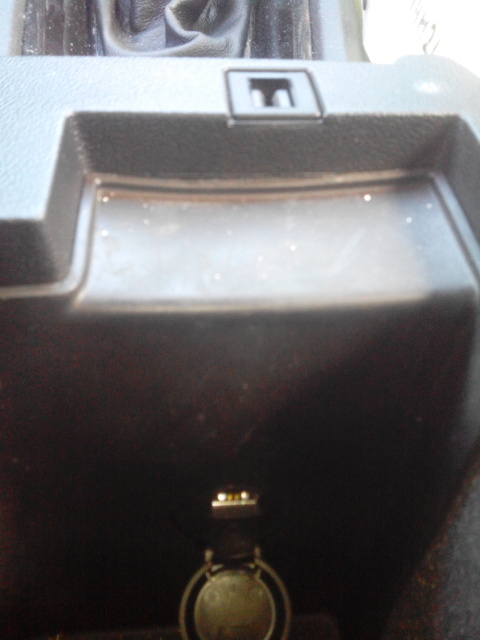

Lasse
Posts: 17
Joined: 03 Jul 2014, 10:26

Bad quality, but still recognisable:
USB and AUX-in. The connecting box comes as standard for the C5 Exclusive.

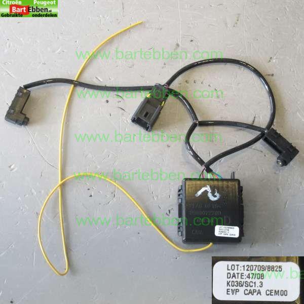

I've found just that sensor module with the LEDs, on another forum, and here's how that looks stand-alone:
I've figured out where they are located, in the top corners, and they're kind of like spot lights from top to bottom ... shame they're blue, I'd like it more if they were orange, but, will see what to do about them when and if I get to it ... I just hope they're not linked to the same input as the under wheel and passenger glovebox, because we haven't been able to get the input from the official schematics (go figure), so it is still hardwired to be linked with the headlights on (low beam) ...
EDIT: I remember qprdude talking about this auto-light door pocket feature on his car, so if he's interested, this is how that magic looks like from the other side of the door ... :)
