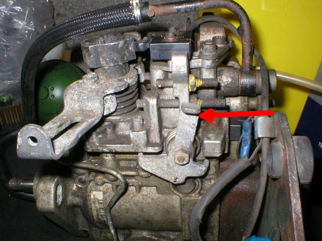

No worries, if that happens, the pump has an emergency stop lever...Rhothgar wrote: Read some horror stories on the internet though where engines have refused to switch off without shunt be removed.
