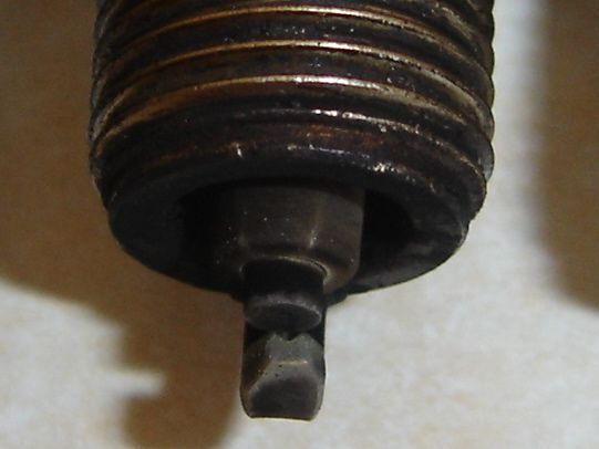

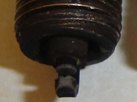

Maybe, if they're not fouled so badly that they don't fire at all, this is how they were in cylinders 4 and 5 last time, fouled so badly they wouldn't clear by themselves: (and that was after only 3 months and less than 1000 miles from new)
Mind you those plugs were a heat range colder than the ones in there now, so maybe they will clear this time with an Italian tune up. :twisted: I get the impression though that a large part of the misfire I'm now seeing (particularly at idle) is once again fouled plugs, (symptoms are very similar to last time thinking about it) but of course something must be causing them to foul in the first place.

They don't look "sooty" - especially the second image.

addo wrote:They don't look "sooty" - especially the second image.
Not sure what you mean ? They look pretty sooty to me. On the second one you can actually see "tracking" where the spark has been burning a path along the carbon on the insulator rather than firing across the gap.
Here's all six for context, they were removed a few months ago.

Perhaps the difference between the plugs provides some clues. The front bank looked good, the rear bank not so much.
By the point these spark plugs had been fitted the faulty spark plug leads to the rear cassette had already been replaced, so its not a case of bad spark plug leads causing the rear plugs to foul...

The only really sooty (as in, oily or cold burning) one to me, is the bottom left. The others just suggest richness or ill-timed combustion.
