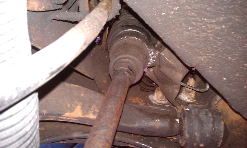

Re: removing inner ball joint Xantia
Its the boot on the inner ball joint, it goes into the steering ram. Its not shifting as it is but there is a split in it which must have caused the wear to the joint. It looks original to me and is not tied on.
Ill order a new rubber cover on Tuesday and have another bash at it then.
This is the boot in question:
So, how do I go about getting it off?
It looks to me like it might go through to the other side of the bracket, where there are toothed like rubber cerations.

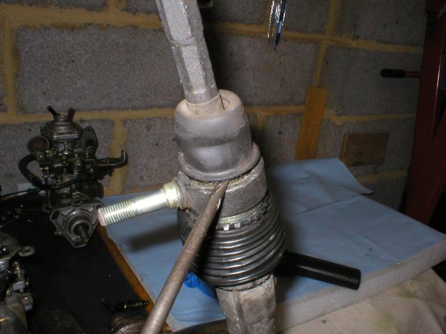

Here you are Chris, some piccys:
car removed fir clarity
Levering off:
What's underneath:
Levering off:
What's underneath:

- Posts: 54947
- x 8291
They are pretty tight Chris but you can get them off undamaged if you carefully but deliberately lever all around the circumference in small steps.Citroenmad wrote: I did try levering the boot off but I can't have been using enough force as it didn't want to move and I was not wanting to damage it.
