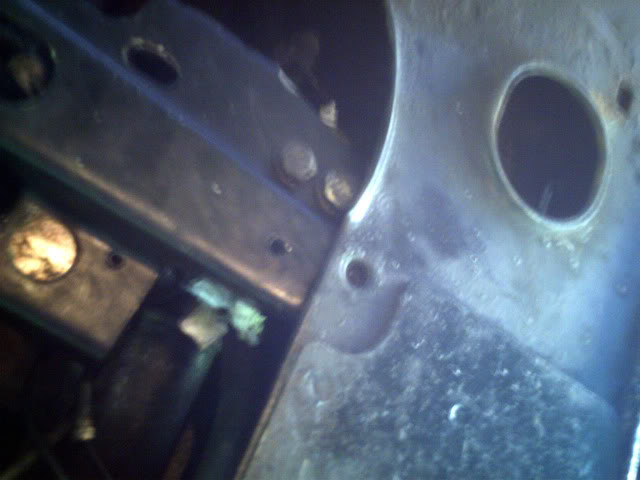

Unscrew the two bolts that connects the height corrector cradle to the sub frame, this will give you a bit of flexibility when disconnecting the linkages.
Using a suitable implement, take the pressure off of the plastic anti roll bar to HC clip by manipulating the bottom plate from the NS spring
and use a screwdriver or pliers to pop off the plastic clip from the metal anti roll bar rod. Another way of doing this would be to slacken the anti roll bar metal link and pop off the plastic link but then the height would have to reset using the table in the following link (link)
Now for removing the manual height control on the OS spring. This is directly touching the spring so it is a case of pulling the height control rod towards the rear of the car and moving the front end of the spring out of its locating dip on the HCR, the other part of the spring can then be slipped out by manipulating the HCR. It may help to loosen the bolt on the HCR to ‘Socket Tool’ (according to Service Citroen) but it would be worth marking exactly where it bolted to as this can be used to vary the length of the HCR.

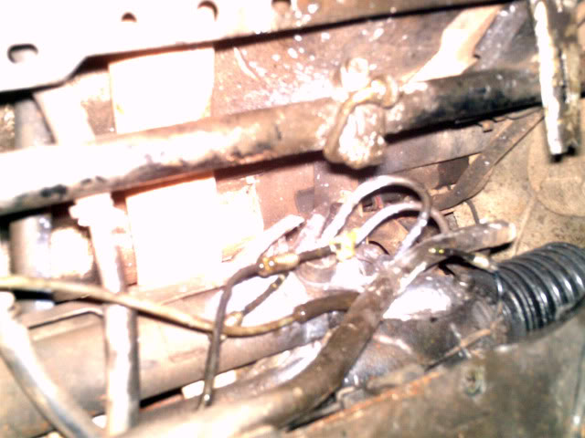

Loosen the three hydraulic unions then undo them one by one before blocking the ends with suitable tissue to prevent any swarf getting into the pipe or height corrector. It may help to unclip the pipes from the plastic holding channel. Make a note of which pipe goes where, on mine, the one with the largest angle is for the union towards the rear of the car.
Pull off the leak off pipe from the top NS of the HC and block with tissue as above.
Now it comes to removing the HC from the car (Bearing in mind that I’m dealing with a car with no semi or fully active suspension). After a bit of fiddling about, I found the best way to be sure that the pipes were either clipped back into the plastic channel or moved carefully out of the way, the HCR also needs to be moved to one side. The HC needs to be moved to the OS an inch or two then the front of the HC needs to continue moving to the OS just enough for the rear of the HC to move towards the NS a touch to drop down. The rest of the HC should then follow; failing that a bit of wiggling should do the trick. I hope that description was clear enough as the photos I took under the car didn’t come out very clear :oops:

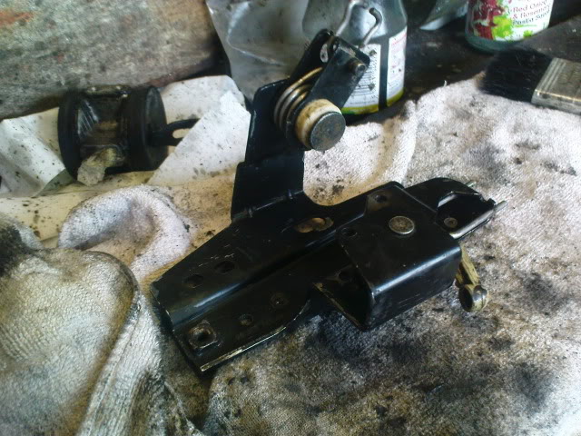

Cleaning the HC
Remove the two bolts underneath the HC
Using a small pair of pliers remove the hydraulic pipe seals from the HC, afterwards renew the tissue.
Now your preferred cleaning method of the linkage, soaking overnight in a tank of diesel, painting with a small brush and diesel or other cleaner until all is clean. Check that the springs move smoothly as you may notice there are still bits of swarf in behind them. A bit of spring moving should get it out along with the small brush.
Using the white grease spray, lubricate all of the moving parts and manipulate them.
Move the HC back into the cradle and screw the bolts back in.
