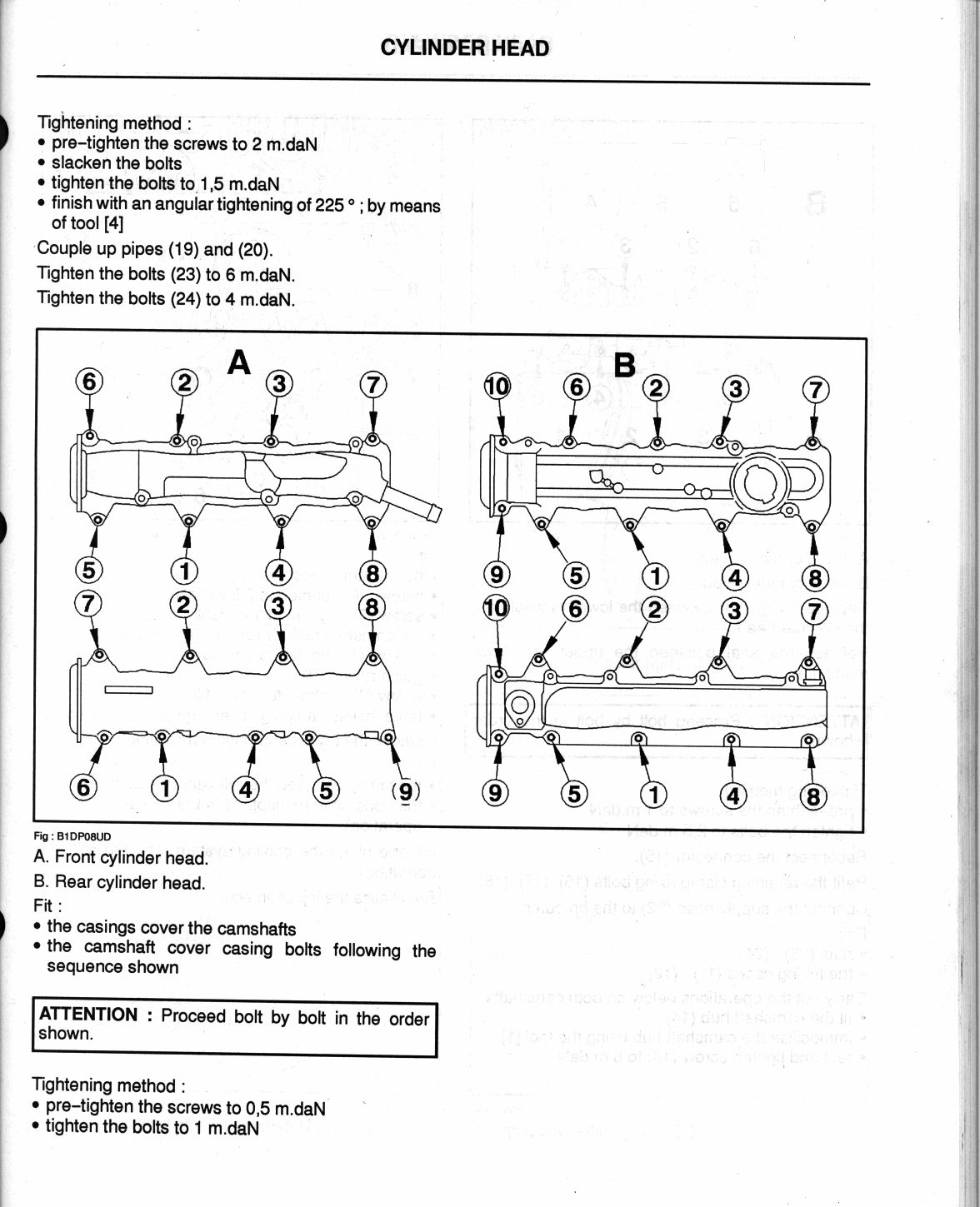

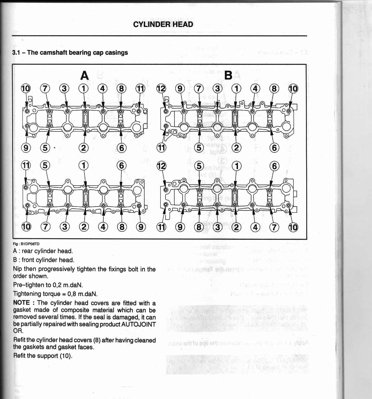

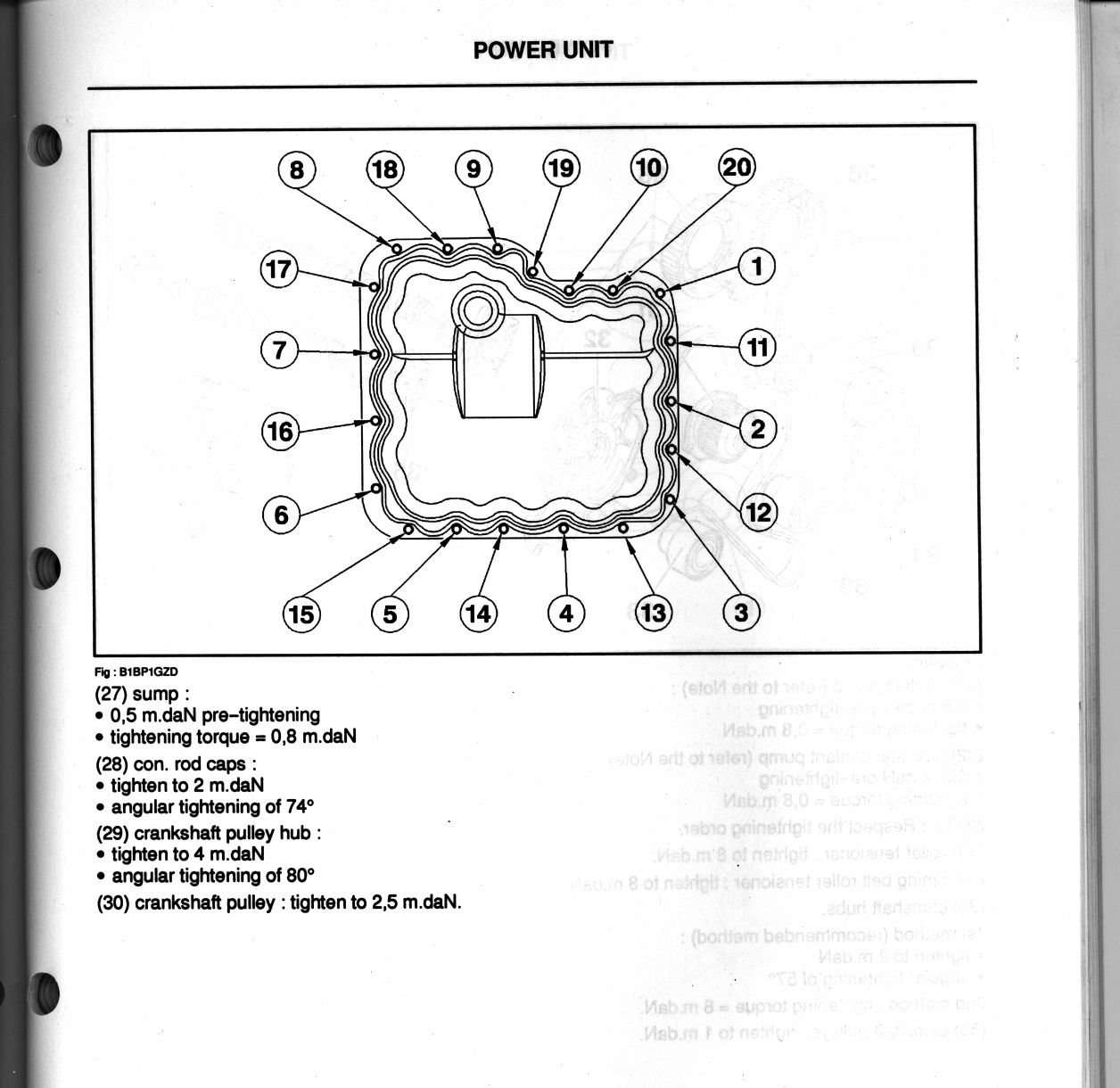

Something that has been delivered.. Some ES9 Pictures David..
Sump tightening sequence and torques
Cam Ladder tightening sequence and torques
Cam Covers tightening sequences and torques
Shout if anything else is needed David....

Jim,
That's superb, thank you.

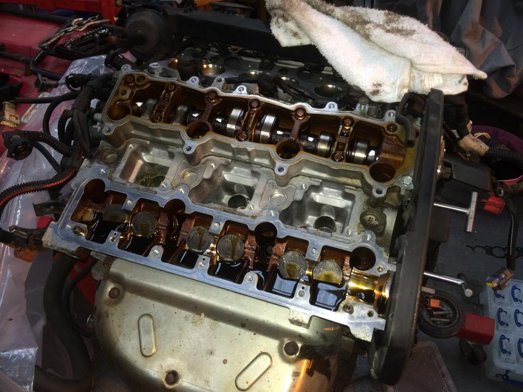

Well, all 4 cam box seals are replaced.
Here's a picture of it with one cam box removed, before I'd mopped all the old oil out:
I didn't take many more pictures as my hands were covered in oil and I didn't want to get my iPhone filthy.

I took the sump off tonight to reseal as it was leaking as well, a couple of the screws were actually loose so am hopeful that with a bead of this Loctite stuff it should stop leaking. Interestingly the sump had a gasket round it the same as the rocker covers. It is no more though as it came off when I was steam cleaning the sump. I'll wire brush the sump tomorrow and give it a fresh lick of paint before refitting and at least then it'll be nice and clean to go in the back of the Range Rover as we venture down south.
