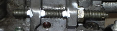

If you can work around them (unlikely) I recommend leaving these adjustable stops so as not to lose their preset positions.
Using white paint again the position of these stop screws are marked and for added confidence I measured the protruding length from the pump body. I will also count the number of turns to withdrawal.
Max RPM stop Image A closer view Image
Anti-stall stop, Full-load screw bottom left Image and Governor shaft screw Image
Any remaining stop/set screws I have aren't worth removing though again, due to differing configurations, your pump may differ. Just make sure you can set the removed items back as they were.

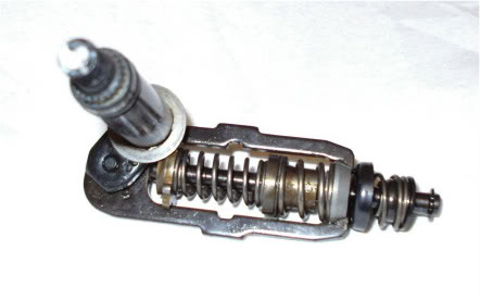

If the parts haven't fallen off, simply take them apart. I prefer to keep them in order for now but will be seperating each part for later cleaning. This how the parts are ordered on the plunger shaft and distributor head
So with the distributor head and springs now removed, we can take out the governor lever assembly by loosening/removing the two pivot bolts either side of the pump with a 14mm socket
Image Image
