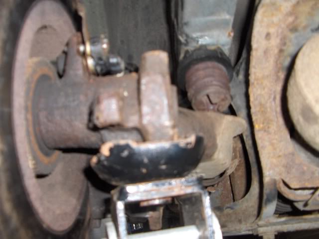

You should now see a roughly oval shaped rusty piece of metal with an ABS sensor going through it. It should be relatively easy to remove the sensor holding bolt, but removing the actual sensor will be a problem as it corrodes itself into place. There are several ways of getting it out depending on how seized it it - prising it out, soaking with WD40, molegrips etc. I had no option but to hack it off using a combination of a junior hacksaw blade, chisel and a hand held drill.

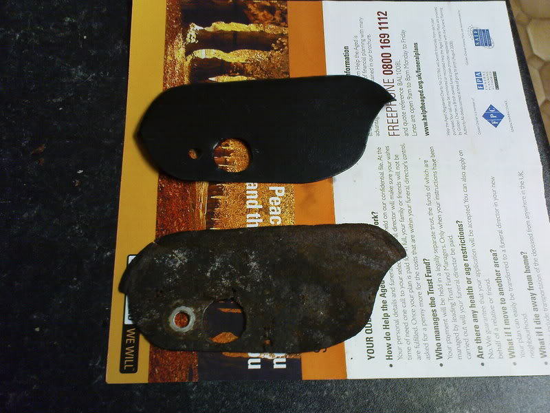

Rusty ABS shield:
While everything is off it would be wise to replace this with a new part from Citroen, though they did quote me a 4-6 week wait as they didn't have any in the UK :o
If you're handy with metalwork, its easy enough to make up a pattern part with the old one as a guide. If not, I'd be more than willing to make one up with heat resistant paint for the cost of materials and postage ;)

Get your new sensor, put the heat shield on and loosely fit it in the hole, its worth putting the securing screw in loosely to guide the sensor in and prevent it being damaged by the ABS cog teeth. It is a tight fit for such a delicate part so use grease and a small tap hammer and cloth or rubber mallet to get it home, tightening up the securing bolt regularly. This bolt should be tightened to 8nm.
