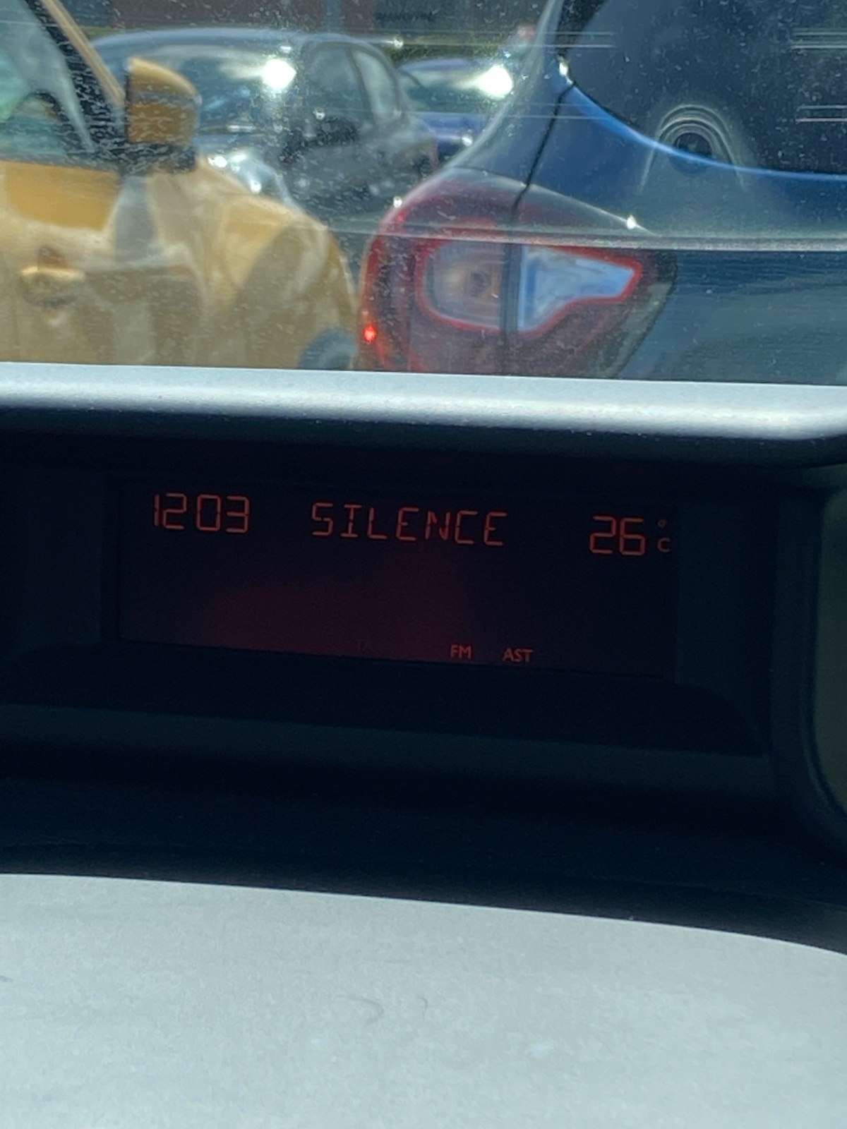

I’ve recently been handed down a Citroen C3 Picasso (2014) and it has for the most part been an alright car… until yesterday. I heard a loud pop and no sound has been coming out the car since. The word “SILENCE” appears when the radio is turned on and when a CD has been inserted, it gets stuck on the reading display. Please help as it’s very depressing to drive this car with NO MUSIC :|

I suspect what you have is a speaker symbol with a line through it and the word 'silence'. If that's the case it probably means you have pressed both the volume uip and down buttons together and put it into silent mode.
Pressing the volume up button repeatedly on the stalk control should get it back to normal.

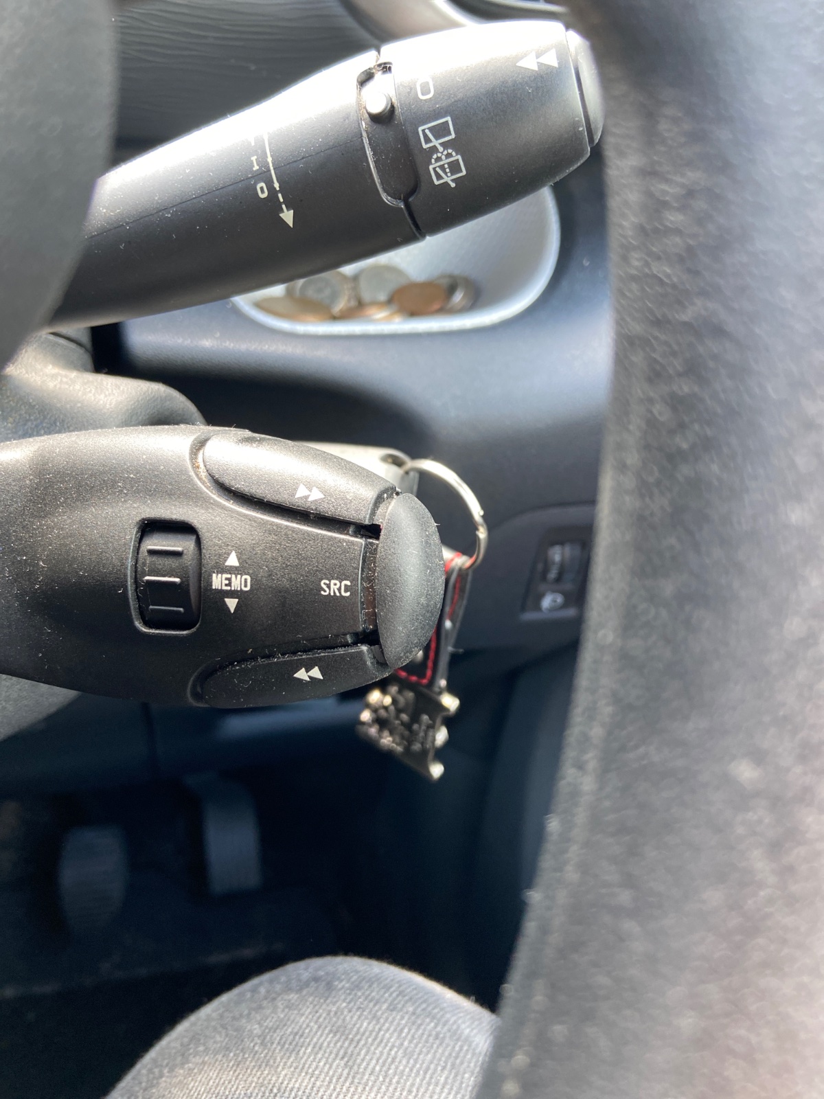

it doesn’t seem to work (media stick volume button solution).
media stick with volume buttons on the back.
Only silence, no speaker sign.

If that does not work you can probably pick up a replacement audio stalk from a scrapyard for a couple of quid (I had to do this for my first C5).
