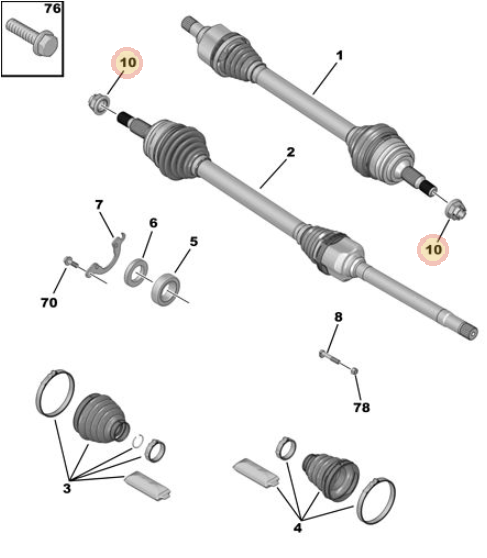

GiveMeABreak wrote: 03 Aug 2024, 11:25 Matt - some confusion...
This 308 with the VIN ending 941 above is not showing a Hub Nut, as the rear hub assembly is not built into the rear disc, unlike the other 308 - have you got the correct VIN? If correct vehicle, can you tell me what other hub nut you're referring to before I answer the other questions so we're talking about the same vehicle, thanks.
Sorry Marc, front driveshaft nut rather than rear wheel hub nut - mixing up my terminology! It's the one you dug out the part number for me recently =
Item 10 here: viewtopic.php?p=807117&hilit=Driveshaft#p807117
Posts: 42019
x 6909
No worries
(10) Driveshaft Self-Locking Nut, Torque: 28,5 da.Nm

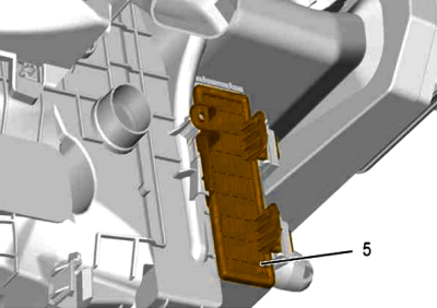

Cabin Filter:
(7) Cabin Filter, 3 Options:
OEM Original Carbon Filter (Particles & Gas), part: 9804163480, £50.96
Cheaper Carbon Filter (Particles & Gas), part: 1612920480, £21.07
Anti Allergenic (High Performance Carbon, part: 1616959280, £63.65
On a LHD this on on the right side, so can't see it being different for a RHD. I believe you need to remove driver side centre console trim (remove centre console side trim cap to reveal screw). You'll need to find the cover as below and remove this to extract and refit the 2 filters. There are 2 plastic clips (tabs) to release the cover.

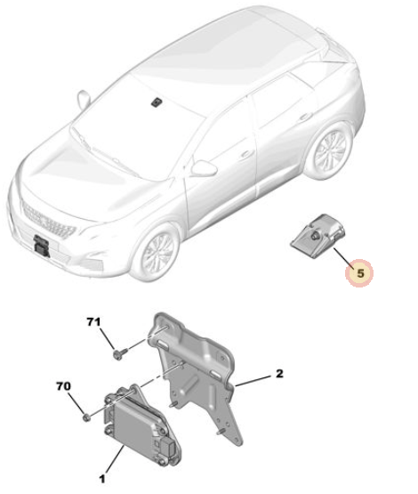

Can i get the oe nr for the front dash multifunction camera for lane assist.
Thanx alot
Posts: 42019
x 6909
(5) New OEM Multifunction Video Camera, part: 1679619080, £620.42
Exchange Multifunction Video Camera, part: 1692666580, £456.48
Remember, in addition to the camera, on this vehicle you also have ARTIV (Distance Control Radar) installed into the front grille. Sme vehicles have camera only based system, others use both camera and ARTIV unit, so you have both.
